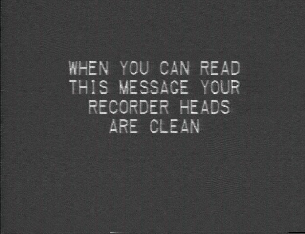

  5. Finally got some screenshots. I have one from each of my two Betamax decks. I hope the problems aren't too subtle to be apparent.
    In this first one, there is a slight background "pattern." It's mostly visible as a vertical stripe down the middle-right side of the picture. If you can see it anywhere, look straight down from the "ADS" in the word "heads."

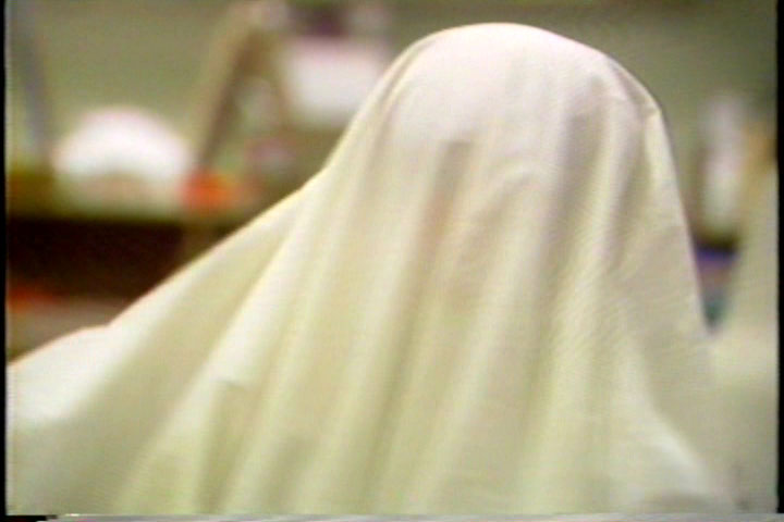

  6. Here's the second one, from my second Betamax. This one has more of a "wavy lines" pattern which can be seen in various areas of the picture. It's more apparent on large areas of solid color. The best place to see it here is running from top to bottom on the right half of the picture. There are wavy lines that are pretty visible on the white cloth of the ghost costume.

    moxiecat, try not to use screen shots from utility screens. They are usually bare bones or crude output that had bypassed the usual chain of events for the final output.
    That screen pic in for your betamax shows a lot of chroma noise (or, salt n pepper) and it was prob on account of the utility screen and type of (pre-recorded and vhs standard video feed that was mastered on these tapes) and should be avoided of analysis/comparison work.
    But on the second betamax, the pic looks beautiful. I mean, there are no chroma noise what so ever. I love it. I wish *all* our standard vhs (and svhs) recording would look like that, but they don't. They always have chroma noise -- the salt n pepper I mentioned about in your first pic demo.
    The noise you are seeing (IMO) seems to indicate you have some form of "feedback" going back into your betamax. I get something similar (hareybone noise) to yours on my Laserdisc player. Fortunate for me, I have a good Monster power strip (costed $79 buckeroes) with noise cancelation circuit for the Video signal and Coax cable (for my analog cable tv) and I get clean pictures every time.
    Without going into much detail.. The feedback I am refering to is the one having to do with ground-loop problems. Could be anything in your house ranging from wall outlets to a cable (old cable tv) that was never removed and is still ground (though improperly) somewhere in/around your house or apt.
    With the power strip I mentined above, and to eliminate the feedback (or your noise pattern) is to connect everything that will produce a picture on your TV set and your Computer monitor and your Capture Card. Anything that connects, either directly or indirectly must be connected to that power stip. There should be nothing else externally (other wall outlet) connected to your computer/betamax/capture card connection, etc.., otherwise you may end up still seeing the noise. Mind you, this is all assuming that your issue has to do with "feedback" noise.

    First, sorry about the "utility screen." (I'm assuming that means it's from a head cleaning tape?) I was looking for a tape that had a dark solid background and that's why I used it. I didn't realize that was a no-no. I'll try to find something else and post a new screen shot.

    Those are power-related (eletrical) noise patterns sneaking into the video. Depending on the severity, most MPEG-2 encoding will cover it up anyway.
    Your player appears to be perfectly fine, don't get it "repaired" by Sony or anybody else. There's a chance it could come back working worse.
    Isolate your power by putting a UPS with AVR between the wall plug and the VCR. Turn off anything else in the house that could cause problems. This includes the air conditioner, washing machine, etc.
    Worse case may be the power into the house is dirty, or the wiring in the house is faulty/inferior (outdated).
    Again, VCR appears fine. Power causes your problem.
    Even the coax/s-video/composite cables could be picking up FM interference.

    The second screenshot, the one that VHelp likes, IS from an MPEG, so the noise patterns weren't covered up. It's from a finished DVD that I transferred rather than a raw source. In fact, I started this post because I saw the patterns on the finished transfer.

    I've never seen BetaMax look that good. Do you have a before example? Normal BetaMax would show more chroma smear.
    The digital artifacts have nothing to do with analog BetaMax.
    Show some sharper horizontal transitions with some chroma saturation, not a white sheet.
