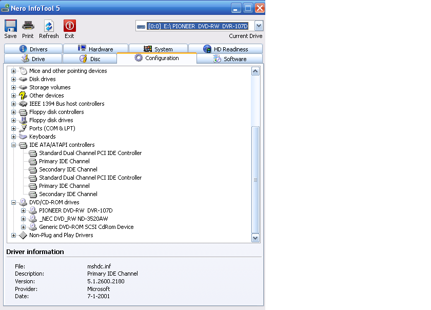

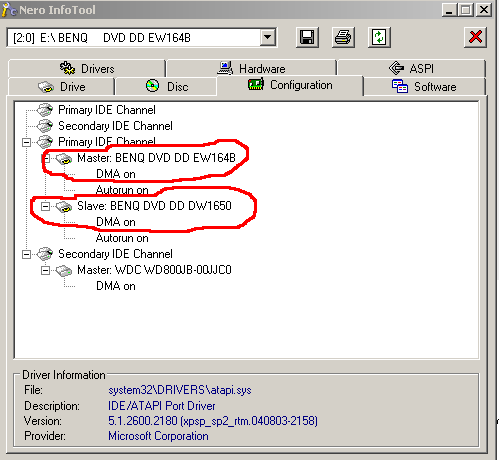

you posted the wrong info from nero infotool. go to the configuration tab and you'll see the primary & secondary ide channels. you will see if your dvd burners are in PIO or UDMA MODE. this is what it's suppose to look like:
Hmmm doesnt look like mine shows this info. This is what I get but I just did a burn and it went fine so I guess somehow it fixed itself
untitled.bmp -
it's because you're using version 5 of nero which is a old version. if you're using crappy media that can also be a reason why you had long burn times. use good quality dvd media like VERBATIM & TAIYO YUDEN.Originally Posted by dqtus
