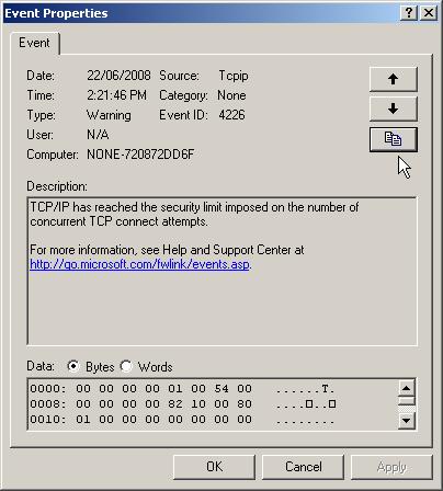

start > run > eventvwr.msc, double-click the error and use the third button on the right to copy the information to the clipboard then paste it here

Do this in event viewer (pointer indicates button to use)
Then in post, just right click, and select paste and the info will show.
Note : If you click on that active link a new window will appear, please read the information as it will list the file associated with the issue which might indicate where the fault exists.
You should also take note of any other system generated errors in the event viewer, and files associated with these errors.
