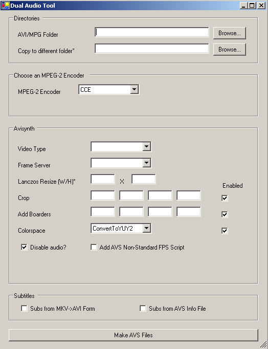

The reason I ask is because I wrote a Avisynth Batch Scripting front-end a few years ago (the more I post here the bigger it gets) for personal use. I would like to add it to my TShed Project, which will be shared with the community as soon as Sourceforge approves it. It will have to be heavily modified as it was really only made for one person.
I want to keep some of the GUI options (colorspace, crop, border etc etc) currently on the form but I want to add kind of a freehand window so you can modify the script. So I was trying to find out if order really matters when calling some of the functions.

FYI, below is a screen shot of what it looks like now. I am sure it is extremely limited for most of the advanced users here, but with a little help that can be changed.

NB: In your screenshot, "Add Boarders" should be "Add Borders".
