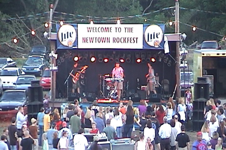

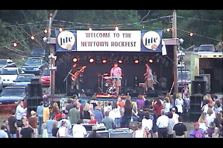

    A brief explanation, both 16:9 and 4:3 can use the resolution of 720X480. If for example you have camcorder that records in anamorphic 16:9 it will produce a video like this, the aspect is not adjusted its just a screenshot at the resolution of the video.
    You'll author this as 16:9 or set a flag to tell devices like DVD player that its 16:9, as Gunslinger mentioned if your DVD player is set to letterbox 16:9 material it will see the flag and adjust the aspect accordingly adding black bars top and bottom. The black bars are not part of the video file but created by the DVD player.

    Exactly the way thecoalman explained it. The widescree image is squeezed into the same size frame as a 4:3 image. The DVD includes a "flag" that tell the DVD player to stretch the image back out when it plays the video. On a 16:9 TV the 16:9 image will fill the screen. On a 4:3 TV the DVD player will squash the image vertially and add letterboxing to the top and bottom.
    Originally Posted by FrancoAnselmo
    OK. I'm not understanding this anamorphic thingy. The letterbox i understood that it's about the flag.
    Anamorphic is the thing i DONT WANT, then? Cause it stretches the video?
    Anamorphic is BAD?
    No, anamorphic good. With an anamorphic 16:9 encoding the picture fills the full 720x480 frame of the DVD. With a letterboxed 16:9 encoding the picture only fills a 720x360 portion of the frame, the rest of the frame is filled with black borders. So you get better resolution on 16:9 TVs with an anamorphic DVDs.
