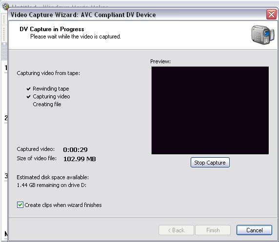

    You didn't provide a computer profile. WMM gives you a choice of all at once capture, scene by scene (detected from time code breaks) or manual cue/start/stop.
    This is the XP version.
    Scenes detected if box checked.

    I had WMM capture the whole tape automatically (the first option in edDV's screenshot), and the scenes I mentioned are those automatically created from timecode breaks. As far as I know, the six big AVI files don't contain scene information; they're just long DV-AVI files. I assume the scene information is kept within Windows Movie Maker?
    So, on the assumption that I'm unable to solve the issue where I can't save in DV-AVI format in WMM, is there a better DV capture program that automatically splits the tape into separate scenes based on timecodes?
