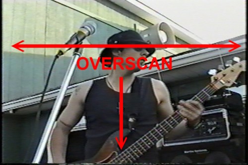

    I believe he means if you were to author the video to DVD. The interference you see assuming its only a small thin line on any side the video resides in the overscan area and won't be viewable on a a normal TV if you authored the video to DVD. If you have no intention of ever putting this on DVD or viewing it on a TV stick with what you're doing however if you want to author these to disc the proper way to do it is mask the area with black. This will maintain the correct aspect and prevent any interlacing issues.
