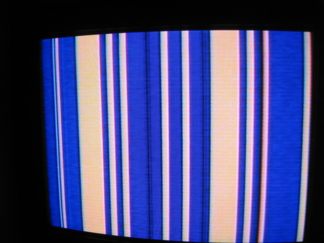

i've uploaded a photo of the tv to illustrate further.

2Bdecided: so when i record the images on a vcr tape, they show up on the tv...but then not by the canon... but the games themselves are being seen by the canon...
i know i've seen some posts about the interlace frames but i'm not even sure what to search- do you think there is a solution?
thanks again- so much! after wrestling with this for 8 hrs alone i'm really happy to have input!
chris

What do you mean? Atari>Canon works, but Atari>VCR>Canon doesn't? Then the answer is obvious!Originally Posted by zimcricket
Or do you mean that normal Atari games work, but your artwork/images don't? If the latter, then the Canon is "just about" working with normal games, but your artwork looks so much like video sync signals that it's confusing it. Or else it's just triggering a different video mode.
I don't think looping it into a TV with an output is going to help - the output will still be non-standard (if the input it).
A TBC might help, but it might make things even worse!
The easiest thing to do is to try a different capture card or digital recorder.

thanks alot,david-
yes you got it-
the games work- the art does not.
i'll make plans to try a dvdr first and then rent some time at my local community video production school.
thanks so much!
and cheers to you,
chris -
thanks all!
success! cheap samsung dvdr is recording the art patterns!
