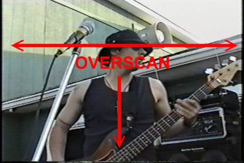

If the first band of noise is juts a few pixels high this is normal, it resides in the overscan area of a TV and is not visible. I haven't seen a VHS or other analog recording yet that didn't have it. Waht you can do is mask the area with black. Here's a typical example:
