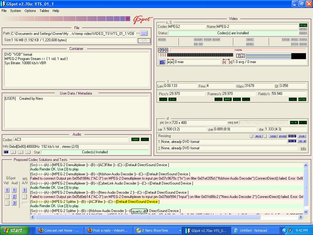

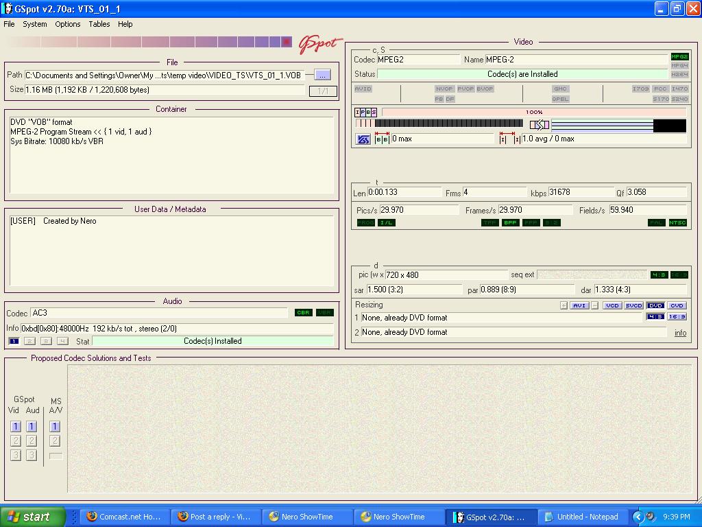

One more thing. Please get GSpot and open your created DVD in it, even if it does not work, post picture to see what is going on.
I almost forgot to ask. Audio for DVD has to have 48 kHz sampling rate, not like CD audio which is 44.1 kHz. -
I have attached a .jpg of gspot after I loaded the main vob into it. It says all codecs are installed. Then I clicked on "2" in the proposed codec solutions and test to render the audio. It looks like the ac3filter rendering works, but when I click on "3" to play the sound, I get nothing at all.

From the scan it looks OK. I really am not sure why it does not work.
