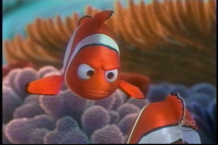

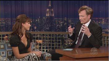

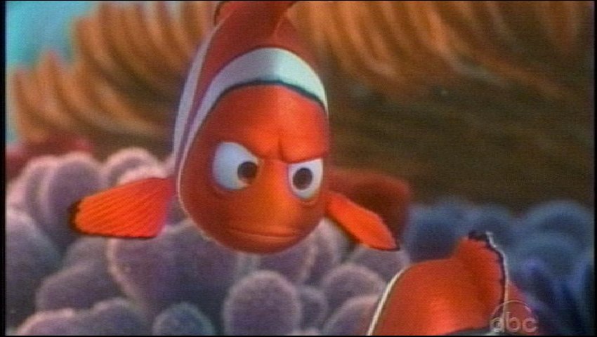

In VX-2000 "Wide" mode, DV viewed as 720x480i will look horizontally squeezed.
A wide shot like this
should look like this at DV output
although the viewfinder will look letterboxed like this
