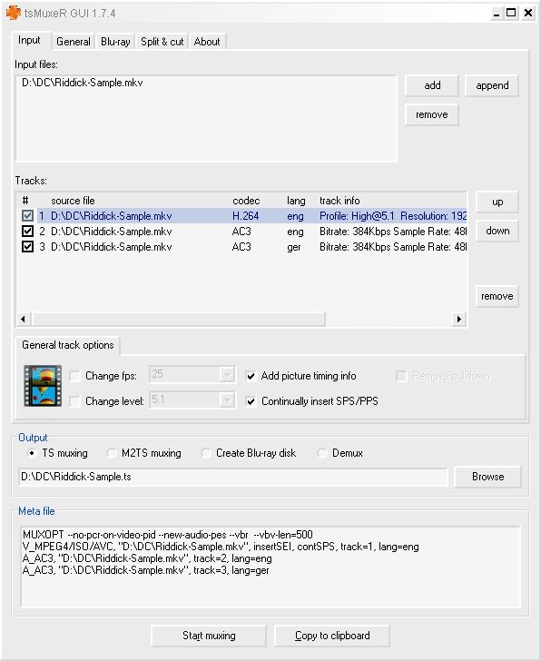

My suggestion is to load the MKV into tsMuxeR and see what profile the video is using. If it is profile 4.1 (or a lower number) then you do NOT have to re-encode the video. If it is a higher profile number (like 5.1 for instance) then you will need to re-encode and if you are going to do that you can re-encode to the same 1080p resolution or you can use a 720p resolution if you want and if you will be re-encoding I can tell you that 1080p to 1080p will take longer than 1080p to 720p.
So how about checking out the video profile with tsMuxeR and letting us know what it says.
When you use tsMuxeR it should look something like this:
In fact the best thing that you can do in order to help us help you is to load the MKV into tsMuxeR and then take a screen shot of it and post it in this thread.
You might also want to load it into GSpot and do the same (post a screen shot of it).

Big problem. The video is Profile 5.1 with 8 Ref. Frames.Originally Posted by NoobyDoo
My understanding is to be compatible with the PS3 (believe this also applies to the XboX 360) you need Profile 4.1 (or lower) and a MAX of 4 Ref. Frames and 3 B-Frames.
Most likely will need to re-encode the video.

I'm starting to see a pattern here.
If it is an MKV then check to see if it is Profile 4.1 or less. If so then TSmuxeR should work. If over Profile 4.1 then try MKV2VOB as it doesn't take long and may work. If it doesn't work then re-encode using a PS3 video profile with LC AAC audio and mux into a MP4 file.

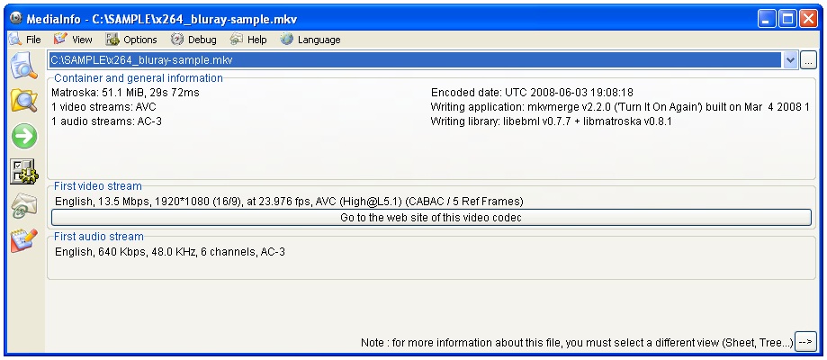

First off here is a screen shot of the MKV using MediaInfo:
Here we see that we have 5.1 AC-3 audio and a 1080p H.264 video BUT the video is "all wrong" for the XboX 360 because it is above Profile 4.1 (it is Profile 5.1) and the number of referenced B frames is higher than it should be.
So right off the bat we realize that we need to convert the video. We want to re-encode it to XboX 360 specs and make it 720p instead of 1080p so that means going MP4. Going MP4 means we need to convert the audio to AAC format.

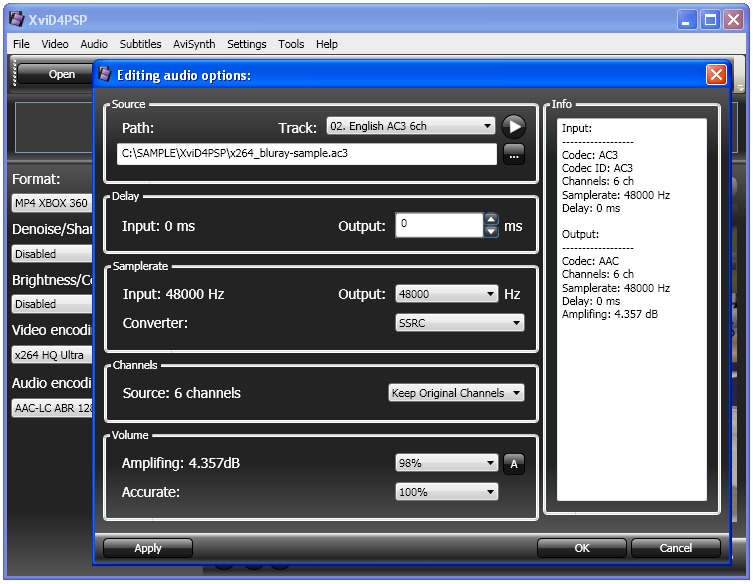

So how do we fix this? It actually is very simple!
Click on CANCEL to get out of the "Editing options" screen. Then go to AUDIO at the top and under that select "Demux" and save the file to a new file. In my case I simply left the file name the same but of course it now ends in AC3 instead of MKV. So my demuxed audio file is called x264_bluray-sample.ac3
Onced demuxed go back to AUDIO at the top and under that select "Editing opions" yet again. You are now going to load that demuxed audio file and set it up so that it looks like this:
In this case I decided to adjust the audio to 98% (you never really want to go 100% or you may "overload" your speakers). When you change the VOLUME SETTINGS be sure to click that "A" icon.
Once I have that set up I click on APPLY and then OK.

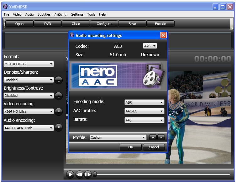

Now the default MP4 XBOX 360 audio is AAC-LC ABR 128 but that really isn't "good" for 6 channels of audio. Please note that I am still learning what are "good" settings but I understand that while you do want AAC-LC you also need more bitrate. I decided to change it to 448kbps because that is what we use for 6 channel AC-3 audio when doing a DVD Video. Granted this is probably "overkill" as AAC is a more efficient form of compression than AC-3 but I would rather have the bitrate be "high" than "low".
To do this you want to click on the "E" next to where it says AAC-LC ABR 128 and a new screen comes up and I configured it like this:
Once this is done click on OK.

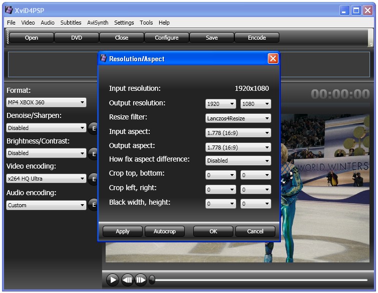

The next step is to change the resolution from 1080p to 720p and to do that we want to select VIDEO at the top and under that select "Resolution/Aspect..." which gives us our next image:
We are going to change it now so that it looks like this:
Please note that all you have to do is adjust the width from 1920 to 1280 and the height is adjusted automatically for you.
Now click on APPLY and then OK. I should point out that if you want to leave it at 1080p then simply skip this resolution/aspect "part" of my guide.

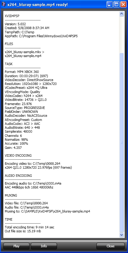

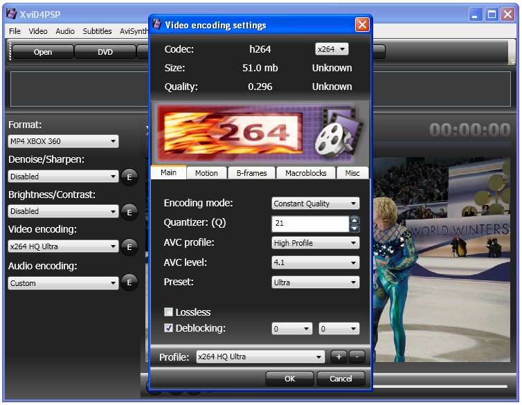

At this point we are ready to encode but there is something I should first bring up ...
The default MP4 XBOX 360 FORMAT setting defaults the ENCODING MODE to "CONSTANT QUALITY" with a QUANTIZER of "21" which seems to be "good" settings and for the sample it is "fine" but you have no control this way over the final file size. This could be problematic for one major reason ... from what I've read (I could be wrong here) but again from what I have read the XboX 360 does not like a single MP4 file to be more than 4GB in file size (the PS3 does not care what file size you have). If true you may want to use a different encoding mode. Even if the 4GB thing is false you might still want to use a mode that allows YOU to select the bitrate and thus the final size of the file.
Let us take a look:
CLICK on the "E" icon next to "VIDEO ENOCODING" and you see this:
Now you can change from "CONSTANT QUALITY" to other modes that allow you to select the bitrate and thus control the final size.
In the case of this sample I left it at the default of "CONSTANT QUALITY" and "QUANTIZER = 21" and I went ahead and encoded it:

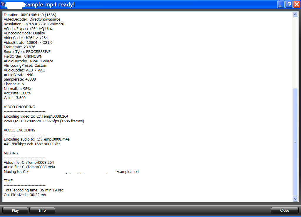

Well I tried your method using XviD4PSP on a sample clip...
Tried both Xbox360 and PS3 profiles....
The PS3 played it perfectly,while the Xbox was not supported...

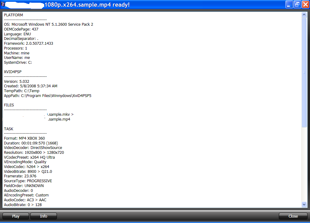

Here's the SS of log using the Xbox profile ,which btw played with the PS3 (yes the xbox profiled .mp4 worked with the PS3),but not with the Xbox console...
