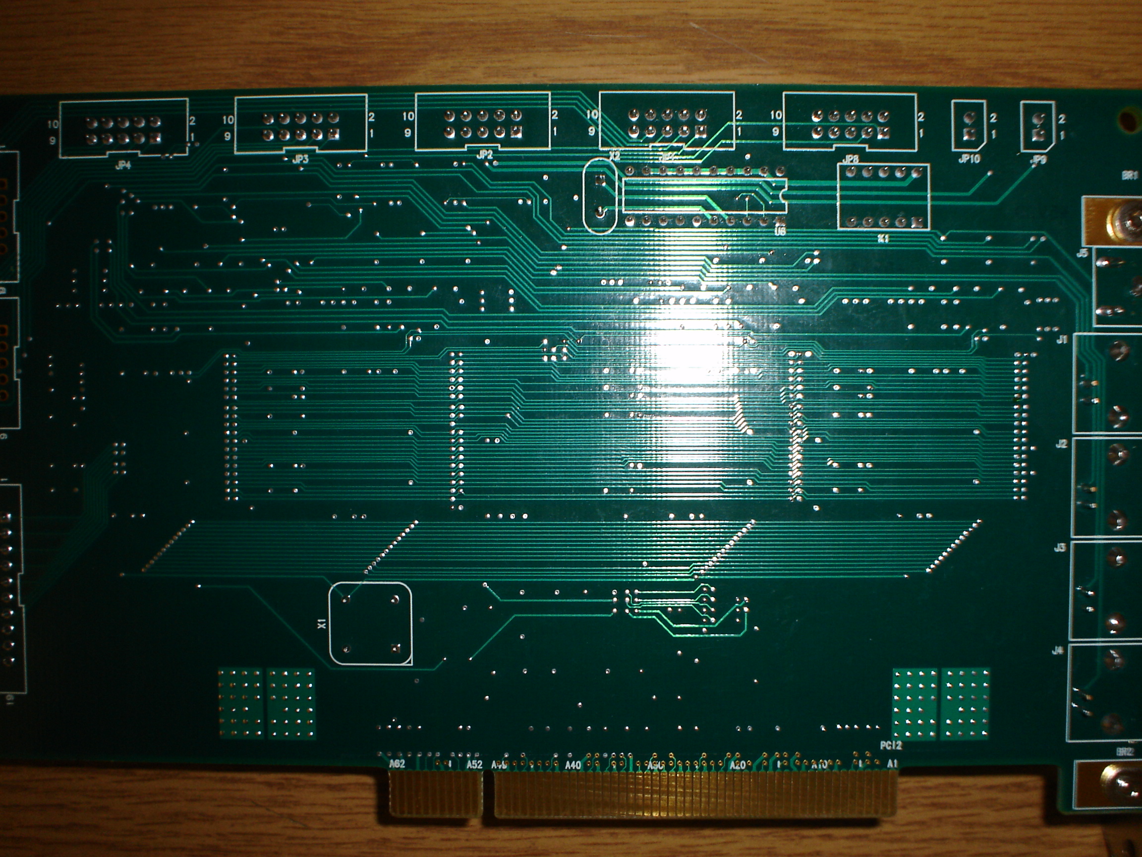

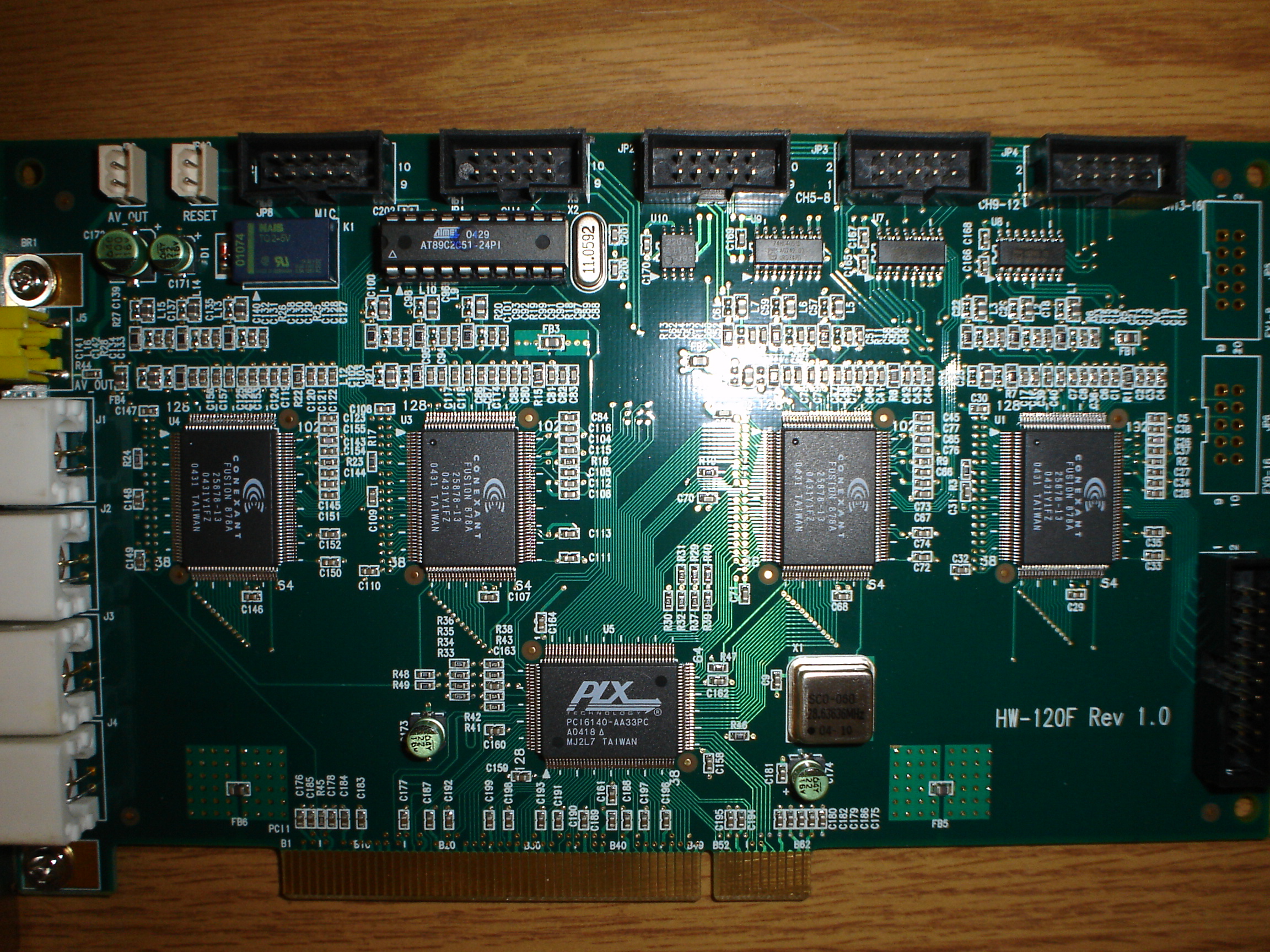

    Ok here's the pictures. I took a shot of the front and back of the card. I don't think it's going to help much, unless you recognize the card by appearance. Not really any kind of identifying marks on it that I can tell.
    Front
    Back

    Why not pull the drivers off the old system harddrive your chances of finding some one with that card is going be very slim from what I can tell on that board it look kind of old I guesting that manufacturer may no longer be a round.
