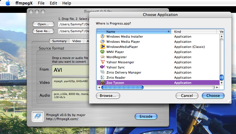

Alright folks, tired of trying to search for this topic but hopefully its posted somewhere and someone can point me in the right direction.
Here's the problem I have with the ffmpegX V0.0.9y
When I hit encode it asks me:
"Where is Progress.app?"
What the heck is this and isn't this supposed to have been installed or with the program already?
Running Mac OS X Panther
See attached file for picture of error message.
Thank you all for your help!!

1/ The "Where is Progress.app" question shouldn't come up at all. But even if it does, it shouldn't ask more than once. Quite weird when it does. Is your ffmpegX application located where it should be ( /Applications) ?
