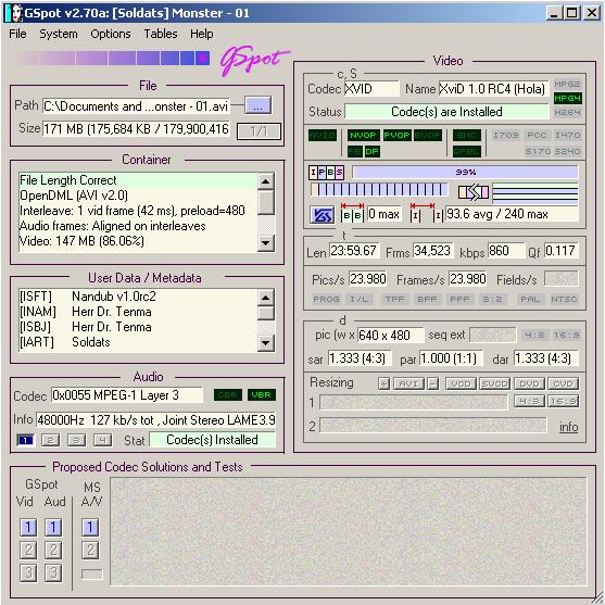

I suggest you post a GSpot image of the file in question. Hard to help without knowing what format the original file is in etc.
You have what appears to be a standard XviD AVI file with MP3 audio. Often times MP3 audio is encoded as VBR (as opposed to CBR) and VBR MP3 will usually go out-of-sync when re-encoding etc.

HOWEVER ... having said all of the above ... I just noticed that you have a frame rate of 23.980 when it really should be 23.976 and I am guessing that the other files ... the files that gave you no conversion issues ... were at 23.976fps
