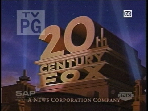

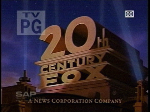

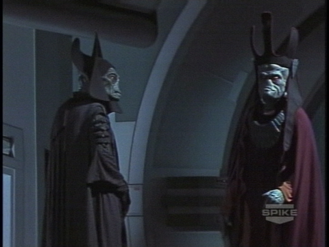

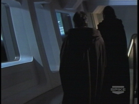

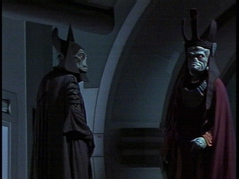

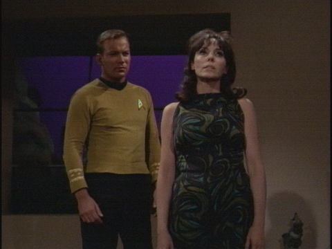

    -- DEMONSTRATION SAMPLES -- of de-watermark images
    To give you an idea of my progress in this area and the work thereof, here is a demonstration
    of some examples. I've also included a short avi clip of the demo below so that you can flip
    through them easily and quickly through virtualdub if need be.
    I realize there's still more work that needs to be done on the filter algo but its a good step
    in the right direction of progress
    SPIKE.TV station logo demos -- analog cable tv source
    vhelp.dewatermark.demo.avi -- 668kb short 480x360 video
    MY9 station logo demos -- analog cable tv source
    -vhelp 4705

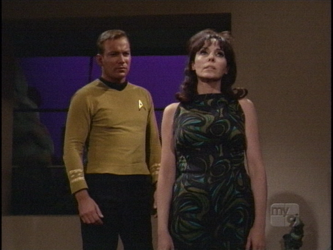

    -- DEMONSTRATION SAMPLES -- of de-watermark images of: MY9 channel
    I added a few more logo demos (above in first post) from my analog cable tv. This set if from the
    MY9 channel. Still waiting (hoping) for some station logos from digital sources
    I'll post more station logo demos of other channels as I find them, try them and so on.
