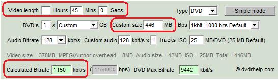

ChezDigital, something you might try is playing with the VideoHelp Bitrate calculator to get a better understanding of sizes, bitrate, etc. You can use the 'Advanced Mode', set your video running time and plug in different bitrates and it will show you what size they will end up as. It works the same with most any format.
I plugged in 45 minutes for video, 128Kbs audio rate and 1150Kbs (VCD bitrate) for the video. It's a handy tool for judging size, or length or bitrate. Just change the different settings. In DVD mode, it shows the authoring overhead. The actual size is also shown, minus authoring overhead. If any of the settings are changed manually, the others will reflect that change.

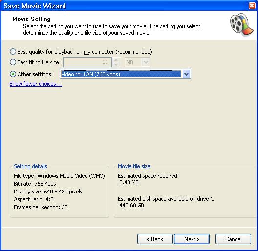

So, this next three-minute video, to be uploaded, was 1.1GB after transfer to my machine. I appended the segments and clipped some frames, and saved the uncompressed files - over 5GB! I'm not a fan of blowing up a file and adding non-existent bits, so what format would I save it to maintain that level of compression (5:1, as redwudz stated)?
Anyways, I installed WME, and encoded the file. I chose the "file download" template, but is there anywhere that lists what settings each of these templates limit you to, and what size your output file may be? I dropped the video down to "1 MBPS VBR"
And am I using WMV3 when encoding with WME?
The file is 640x480, 3:10 in duration, and 32MB in size. I realize that when the demand is to upload, file size is primary, but the quality is crap, and I have received humorous e-mailed WMV clips of this length that are only 5MB, and MUCH better quality! What can I do better, using WMV3? -
