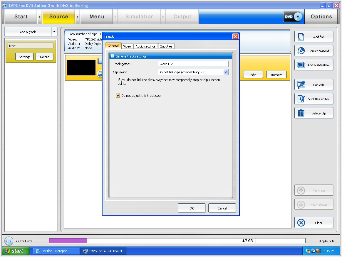

I also use TMPGEnc DVD Author 3.x
Here is a (rather large) image:
On the left hand side where it says TRACK 1 there is a "Settings" button. When you click on that the "TRACK" dialog box opens as you see in this image.
By default the option called, "Do not adjust this track size" is NOT checkmarked. When that is the case the so-called SMART RENDERER in TMPGEnc DVD Author will "kick in" if it thinks that it is needed. However if you checkmark this option (as seen in the image) then TMPGEnc DVD Author will NOT do any re-encoding.
So you want to make sure that you DO checkmark that option.
That should (knock on wood) solve the problem ... but ... that still leaves us with the pulldown issue. Maybe something is wrong because "back in the day" I used TMPGEnc DVD Author 1.5 (and 1.6 which worked very much the same) and if the file is truly compliant (which it should be) then you should NOT get that error msg.

Fulci, with the "Do not adjust this track size", do I have to do that on every DVD I make in Version 3, or will it remember it everytime. I just went in and checked that but the lines were still there, maybe they will go away when it renders the DVD files. With TMPGenc Author 1.5, what you saw in the preview is always what you got on the DVD, without exception, that is why I put so much faith in Version 3's preview. The only reason I was using Version 3 was because Version 1.5 does not play AC3.
Again, I want to thank everyone. Now I can actually test my new form in my VB.Net application I wrote Friday for HCenc
As far as I know you have to checkmark that "Do not adjust this track size" option every time. In fact if you have multiple tracks on a single DVD you need to do it with each and every track. Maybe there is a way to do it globally but if there is I haven't discovered it.Originally Posted by Maikeru-sama

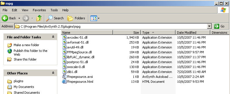

@45Tripp, I got the FFMpegSource Files from the link that AlanHK posted in this thread on page 2:Originally Posted by 45tripp
http://avisynth.org/warpenterprises/
On that webpage, if you go down to FFMpegSource, there is a link:
http://avisynth.org/warpenterprises/files/ffmpegsource_20071006.zip
When you download that zip file, it will definately make an "mpg" folder, I just did it to make sure so as to not incur your wrath

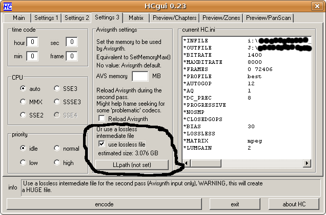

HC 'lossless' option,
encodes to a lossless format on the first pass, and then uses the lossless file for input on pass 2.
aside from mismatches, and mainly,
it's also a speedup technique when using heavy avisynth filter chains.

Settings tab 3 near the middle/bottom.
Originally Posted by [url=https://www.videohelp.com/tools/HC

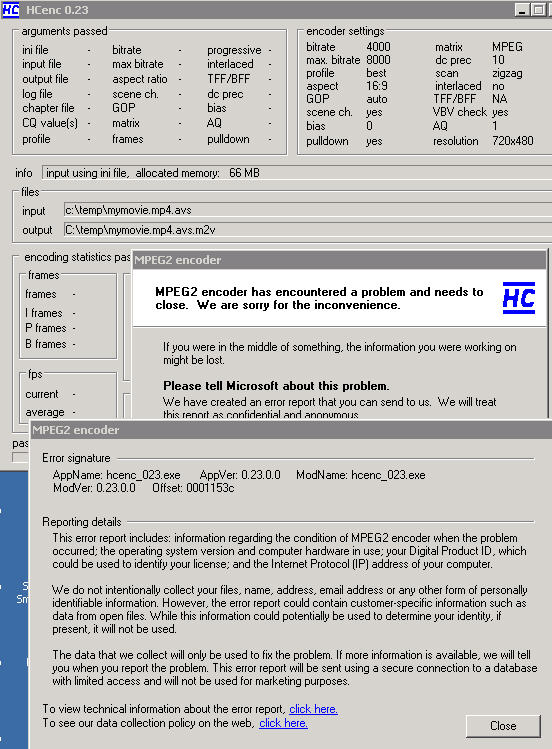

Hank, here is a screen print and INI:Originally Posted by hank315
Code:*INFILE c:\temp\mymovie.mp4.avs *OUTFILE C:\temp\mymovie.mp4.avs.m2v *LOGFILE C:\temp\mymovie.mp4.avs.log *LLPATH D:\Movies *BITRATE 4000 *MAXBITRATE 8000 *FRAMES 0 33682 *PROFILE best *AUTOGOP 12 *AQ 1 *DC_PREC 10 *PROGRESSIVE *LOSSLESS *PULLDOWN *MATRIX mpeg
Also, I noticed that it said it was going to create a file that was 5.86 Gigs, which seems pretty large. However, the drive it is on is 100 Gigs, so that is not an issue.
Here is the error code. I tried to find the "4e10_appcompat.txt" on the Hard Drive, but I could not find it.
Edit: I forgot to mention, it crashes both when I set the Lossless file path and when I don't. Also, the AVS Reload feature seems to be working now, so that is no longer an issue. Also, I knew it was a long shot, but I turned off SpyBot to see if that was the issue and it wasn't. -
