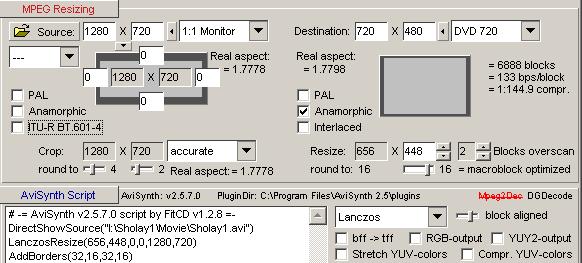

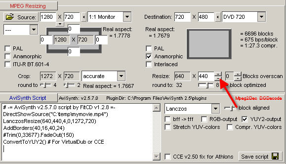

  3. If you insist on losing resolution and adding black, I get this:
    LanczosResize(656,448)
    AddBorders(32,16,32,16)
    Since there's no cropping being done, I removed that part of the resize line. Try as I might, I can't reproduce your script in FitCD, although I'm sure you generated it somehow. Personally, I don't think adding black is such a good idea. But that's up to you. Of course, that "flashing" is interlacing. If there's a lot of it, that just means the guy that made it is an idiot that didn't know what he was doing. You can remove it with a conditional deinterlacer like:
    Because there's no cropping done, I removed that part of the Resize line. Personally, I don't think adding black is such a good idea. But that's up to you. Of cource, that "flashing" is interlacing. If there's a lot of it, that just means the guy that made it is an idiot that didn't know what he was doing. You can remove it with a conditional deinterlacer like:
    TDeint(Full=False)
    Manono, let me ask you something. I stopped using the "Blocks Overscan" scroll keys a long time ago. I just use the scroll keys to the right of the "448" in your picture until I get 640x440 as my TV has really bad Overscan, especially horizontally. Is there a difference between the two scroll bars?
    I am going to go into FitCD and use the blocks overscan scroll keys like you did and then retry.
    Apr 2006
    Manono, here is what I was saying, just to make sure I wasn't confusing you.

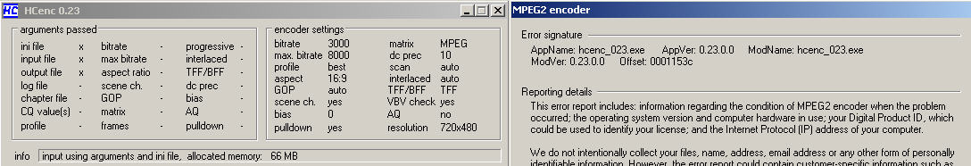

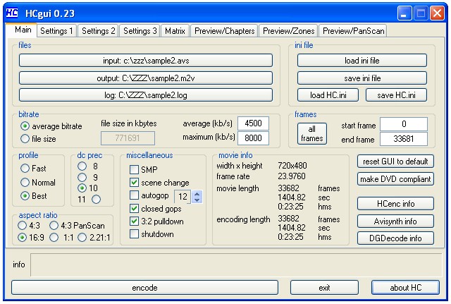

    @45Tripp, here is an update:
    Scenario1 - I tried using "TDeint" as manono stated and both CCE and HCenc crash at first attempt to encode.
    Scenario2 - I tried WinFF using the NTSC Good and High Quality presents and it eventually crashes FFMPeg. It does render an MPG file but when you view it, it is just a black screen with avisynth errors.
    Scenario3 - Tried using Avanti and that eventually crashes FFMpeg as well. This was not the Job list but just one file. Here is a screen shot that has the settings I used:
    link
    Scenario4 - I downloaded Super, even though my experiences in the past were not very good. I figured it is a new verison than what I last used and of course, I loaded my avs file and it bombed right when I hit the encode button.
    Sorry I don't have any of the exact errors for all of these scenarios. I have already deleted the m2v file that HCenc encoded, but once I get some time, I will re-do it and upload a small portion of it on Rapishare or something.
    I have decided to just give in for the moment and right now I am back to square one and just using CCE. I have about 15 files with the same exact settings as the file I posted. CCE crashes quite a bit while trying to encode them, but normally, after re-loading it, it will finish, which is very annoying. I may try Fulci's way but right now I have been working on this problem for so long, I don't feel like trying another software app.
    If push comes to shove, I may just use Quenc, but no matter what settings I use, it still renders a 800 MB file, when all the other encoders based on the same settings are around 500 MBs.
    I would really like find out why I can't use a "lossless" file in HCenc. I tried it on another file which is an AVI and it crashed as well. I wonder if it has to do with Anti-Virus software. I am thinking maybe is I can get rid of the source mismatches, than the lines in the rendered file will go away.
    Anyway, thanks for all the help.

    Apr 2006
    @45Tripp, I just downloaded the FFMpegSource DLL and unzipped it to the Avisynth Plugin folder.
    However, when I try to open it in VDM, it says that is cannot load the plugin. When I unzipped it to the Plugin directory, it made a sub folder called "mpg", so I tried putting all the files in there into the Plugin root but that didn't work either.
    Let me ask you an extremely basic question because something you said is confusing me. You said you were confused about the "16:9" aspect ratio. I don't have a HD television, so I always thought I needed to choose 4:3. You are correct, my source is 16:9, but as I stated, I thought that was for HD TVs. Please advise?
    How would I check for system/codec stability and do you want the MP4 file or the M2V file renderd by HC or both?
    Also, for all the scenarios, I used the same exact script that I posted here and I did check them in VDM and they worked fine.

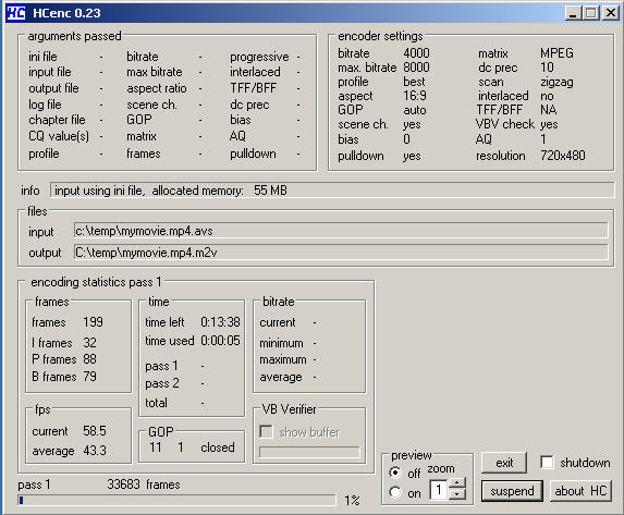

    I was able to finally load the avs script with Deinterlacing into HCenc, but got the same results.
    Fortunately, everything has started to load after I re-installed CCCP. I just wonder if there is still some sort of conflic going on with some software. I know I had to totally remove AVI2ISO because some of the software it installed was causing some problems.

    Here is picture of the error I get when I try to use "lossless" in HCenc

    I then did this with FitCD:
    Using the resize values from FitCD I created the following AviSynth script:

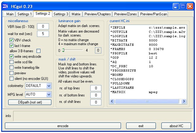

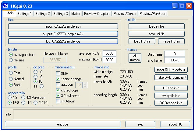

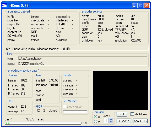

    I then opened the file into HCenc 0.23 which is the first time I've used that version although I've used 0.22 many times with no real issues. I only changed the first 3 tabs in HCenc so that it looked like this:
    That last image is just to show that it started to encode without any errors. Right now as I am typing this it is at 65% done on the 1st pass but I see no reason why it would "error out".

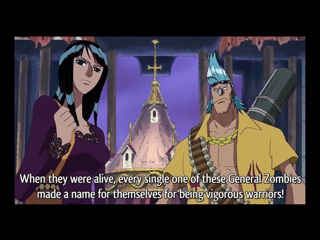

    Well it turned out fine on my end and it looks/sounds great!

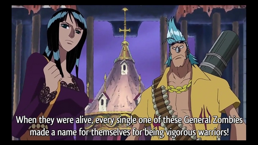

    Here are two frames from the final MPEG-2 DVD spec file created by HCenc:
    FRAME 01
    FRAME 02
    This is how they are encoded. I encoded in 16x9 WS but it will play back properly on a 16x9 WS TV as well as a 4:3 TV depending on how you set up the output on your DVD player. This is how most widescreen DVD Videos are created.
    For a standard 4:3 TV you should see something that looks like the following:
    FRAME 01
    FRAME 02
    For a 16x9 WS TV you should see something that looks like the following:
    FRAME 01
    FRAME 02

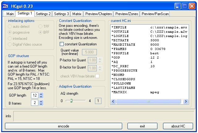

    @Hank, I have copied your same exact settings (the only difference is that "DC_PREC 10" and GOP is 12 is in my INI file).
    I am going to encode and when I get back from working out, I will tell you what the results were.
    If it doesn't work, I think I may reformat my system next weekend, but the only problem is I don't know what is causing the problem.
    Can you tell me how many ffdshow video decoder and haali media splitter icons were in your systems tray? While HCenc is encode, there are 2 of each for me.
    Also, not that it matters, but do you know why my HCenc looks different from yours?

    Well I decided to try yet again for you.
    This time around I used the following AviSynth script:
    DirectShowSource("C:\ZZZ\mymovie.mp4", fps=23.976, convertfps=true, audio=false)
    LanczosResize(656,448,0,0,1280,720)
    I called this sample2.avs
    I loaded this in HCenc 0.23 as before with all the same settings except this time I used 4500kbps instead of 5000kbps for the video (average) bitrate.
    I'll let you know how it turns out when it is done but it appears to be encoding A-OK (knock on wood).
    Oh and as to the reason why all of our HCenc windows look different ... I'm using the standard WinXP theme whereas you appear to be using the "classic" WinXP theme and I'm assuming that hank315 is also using WinXP but with some other theme (or he just changed the colors etc.)
    - John "FulciLives" Coleman
