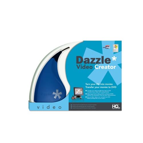

I've already tried Dazzle Video Creator but the quality was not good at all, to be honest it was aweful.

The dazzle toy you showed (or any other for that matter) cannot give you any best results because you'll feed them with your digital signal already distorted in the process of converting it to analog signal, then the dazzle will encode it back to digital mpeg compression. If quality is the factor important to you, you have 2 completely useless and obviously distortion-adding conversions in the process before you have your 'final product'.Originally Posted by galaxy_110

I guess any of these toys like dazzle or other can do at least 15mbps CBR MPEG-2 at 720x480 if you connect them thru USB2.0, so dazzle is as good choice as any other
Just make sure the capture card/toy don't have any MacroVisioCrap, because they'll give you grievance when you'll transfer tapes that are not in pristine quality (they usually 'think' every glitch of old VHS is a MV protected copyrighted materialOriginally Posted by galaxy_110

I am NOT enthused at all about USB based capture solutions. I just don't trust them. Give me good old PCI cards any day.
Back in the day (American slang for "in the past") Dazzle made a great PCI based card called the DVC-II. Then they dropped it and went with USB based solutions and none of us fans of the old DVC-II are very fond of their newer cards. The fact that DereX888 keeps calling it a "capture toy" should be a clue to you what he REALLY thinks of this card.
I would recommend instead that you consider a Hauppauge card. The older PVR-250 or PVR-350 models are rock solid and work well for everybody. They can't capture high definition though, which may or may not be a problem for you. I have no experience with their high def capture cards. If you are trying to copy VHS tapes that you recorded yourself, than you will have no problems. If you are trying to record commercial tapes, they will have Macrovision on them and you will need a card that defeats this. I am not sure which cards can defeat Macrovision. -
