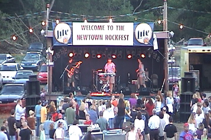

    16:9 and 4:3 DVD compliant MPEG both use the same resolution of 720x480, here's a full frame. Note the people are tall and skinny and the miller lit signs that are circles have an oval shape:

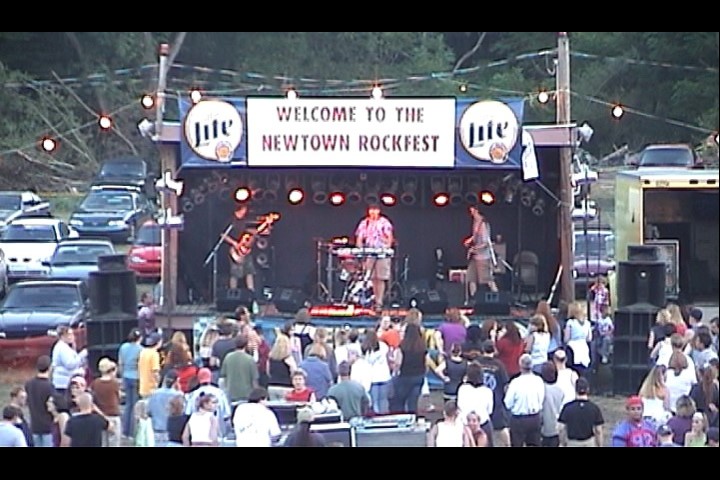

    You author this as a 16:9 DVD, assuming your player is set correctly it will read the 16:9 flag on the DVD and it will letterbox it to maintain the aspect. The black bars are added by the plyer, they are not part of the video file.

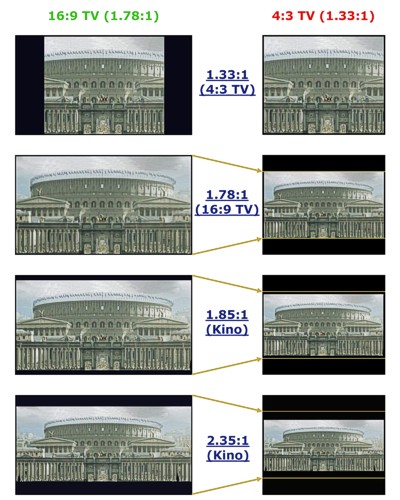

    This graphic explaination tells all.
