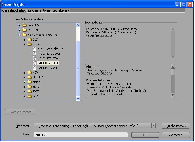

The more expensive alternative is Premiere Pro with the Mainconcept MPEG Pro HD plugin, which will do smart-rendering also. -

Premiere Pro with the Mainconcept MPeg2 plug-in is what you need for high end work. It does fine with SD. It started with SD.Originally Posted by neumannu47
This plug-in replaces the stock Premiere Pro uncompressed RGB or YCbCr video path with the Mainconcept MPeg2 codec. All (or most) Premiere filters are transcoded to MPeg2 including multi-level compositing.
It looked good at NAB, try the demo.
http://www.mainconcept.com/site/prosumer-products-4/mpeg-pro-hd-7850/information-7862.html

So, just to be clear before I spend the time and the money, if I get Premiere Pro with the DVCPro50 plug-in, I can import an MPEG-2 file, edit it, and save it without re-encoding the entire file. Is that correct?
It seems that the information I read is correct. Premiere Pro will not natively edit MPEG-2 on its own without a lot of hand-holding. It seems that this plug-in gives Premiere Pro the capability. -

Premiere Pro capabilities are detailed in the Mainconcept plug-in descriptions. http://www.mainconcept.com/site/prosumer-products-4/dvcpro-50-plug-in-17983/information-17994.htmlOriginally Posted by neumannu47
Premiere Pro or most other pro editors will recode. Import means just that. DVCPro50 will be imported and converted to the project format (typ YCbCr or RGB).
Products like womble will recode all GOPs that have edits, transitions or other changes applied.
If you have DVCPro50 quality masters, you should either edit uncompressed SDI or with the Mainconcept MPeg2 plug-in with DVCPro50 add-on.Recommends: Kiva.org - Loans that change lives.
