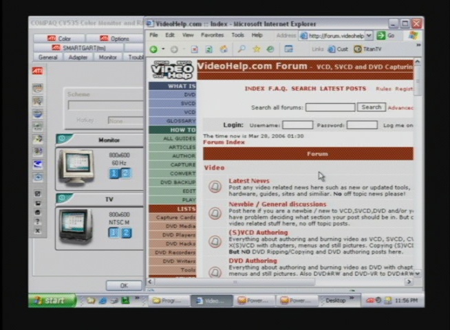

VGA is completely different than composite or s-video. Cheap VGA to composite or s-video converters will get you very poor results. Expensive VGA to composite converters will give you poor results. Simulated example of a good converter:
https://forum.videohelp.com/topic345015.html#1849172

Here is an actual 800x600 to S-Video out (ATI-9550) to S-Video in (Canopus ADVC-100) frame cap. A scan converter will produce lower quality than these idealized captures.

I saw the photo you posted as an approximate on the other thread and i cant say its bad.Well its bad for paying the money for the box,but not bad considering the use i want it to be.
