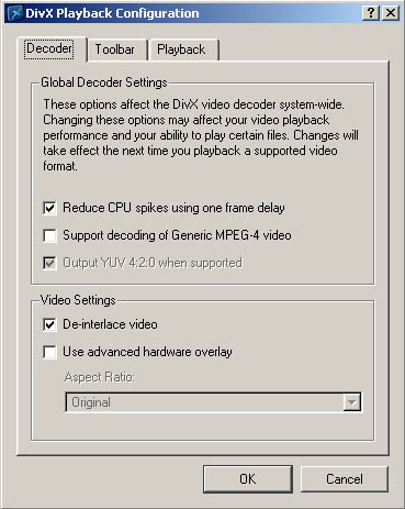

  2. To keep Divx from playing Xvid files disable the "support decoding of generic MPEG-4 video" option in the Divx Playback Configuration utility. This probably won't fix your problem though.

    Also, untick "Use Advanced Hardware Overlay".

    I had overlay already unchecked and I unchecked generic mpeg-4 option.

    Just updated DivX today and once again, the decoder took over AVI playback. It was easy to fix this time by just by unticking "support decoding of generic MPEG-4 video". I also had to untick "show DivX logo matermark. Pretty sure I'll have to reinsert the DivX Pro serial number.
