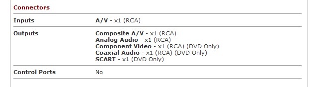

According to this, you have a multi-system unit and it does have composite, component and SCART out. The manual should show a possible SCART to S-Video connection with adapter.Originally Posted by Airliban
http://www.bhphotovideo.com/c/product/531835-REG/Toshiba_SD38VKR_SD_38VKR_Multi_System...VCR_Combo.html
Regardless, you should be getting video over composite to an NTSC TV if in NTSC output mode and in PAL in PAL output mode.

Check your manual. The link above says you have a composite output. Maybe it is located on the SCART connector. You can buy adapters.
It also says "Important Notice! Must be played back on a multi-system TV."
That means PAL discs need a PAL capable TV and NTSC discs need an NTSC capable TV.Recommends: Kiva.org - Loans that change lives.
