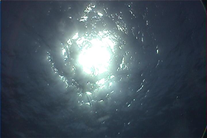

A screenshot of an example frame would really help.
Noise can mean a number of things. If it is grainy, it is probably an analog problem - e.g., too much gain/too fast shutter etc. If it is blocky, it is likely digital and probably a dirty head or misaligned tape path. With dirty heads, you usually get a few horizontal bands of garbage alternating with bands of clear picture (there are two heads on the drum).John Miller -
Thanks, there is no banding. I cleaned the heads then tried the same tapes but no improvement.
I attach a screenshot. The GL2 produces much better pictures than this. This looks like a picture produced on a cheap $200 camera.
still1.jpg -
I agree - I've taken a still from WMP from a clip of my own where there is very high contrast (to compare with the forest view with the daylight). The level of vertical detail is higher. In the forest view, the level of vertical detail seems about half. I've looked at both images in detail (highly zoomed x500%). Otherwise, the image doesn't show any signs of analog or digital degradation.
John Miller
