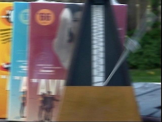

I have a Sharp XR-10S Projector that I use to watch movies with. Some movies display weird when there is motion. For example, when a person in the film jumps to the side, they become "lines" blurred motion until they stop/slow movement. I don't know what causes this, or how to avoid it. I'm using composite video cables to hook my projector up. Ask me if you need any other infortmation. How can I have all my movies smooth? and be rid of this "tearing" motion once and for all.

Also, those pictures helped a lot! Thank you for taking the effort to post them. By tearing, I mean interlace comb artifacts. As pictured in the TOP photo. What is causing this? What can I do?

I'm going to guess you don't see the comb artifacts on the computer, that other sources look ok via composite cable, and that your AVI files are 23.976 or 25 fps.
To send these over a composite cable the video has to be telecined to 59.94 fields per second. To be displayed by the projector these fields are being recombined back into frames. Sometimes the projector is combining fields from two different frames -- so you see comb artifacts when there is motion. I don't know how you might get around this since it appears to be a problem in the projector.
I think that projector has a VGA input -- have you tried using that? That would avoid the whole telecine, inverse telecine issue. -
Yes, I think it will solve your problem. And deliver better picture quality too.
Do you see the comb artifacts on the computer monitor? If so, the VGA cable probably won't help. You can try a player with deinterlacing options like VLC or KMPlayer. It would be rare for an Xvid file to be interlaced though. -

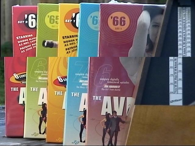

I have the issue on the second picture :
Not the comb but the tearing. I have it only on some videos, and I am seeign it now on a 24" display I bought (1920 x 1200) when playing some videos with the following spec in Mplayerc

Tearing can usually be fixed by using Video Overlay. There are some graphics card and driver combinations that don't work properly. Some players have workarounds that help. For example MPC has a "lock back-buffer before presenting" option, VLC has "Use triple buffering", etc.
Cabling doesn't matter. -
Thanks. I tried the lock-back buffer thing in MPC. Still won't work. Let me clarify that the issue is when there is motion on the screen. I am getting the same even with mp4 files : Video: XVID 720x416 25.00fps.
I am running my LCD at 60 Hz refresh, and it has a 5ms update spec. I thought that was enough to play 25 fps. Should I make the refresh 50 so it is an integer multiple?
