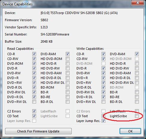

    LightScribe is an extra cost addition to a drive and some drives come in two versions, with and without it.
    A program like ImgBurn will tell you what capabilities your optical drive has. Go to 'Tools>Drive>Capabilities'.
