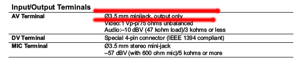

 Found a copy of the manual online here : http://media.onecall.com/Image_Products/Canon/ZR500_man.pdf as shown in the extract (below) this camera does not support analogue video input, and cannot be used for pass-through.

	Thanks that's what I thought, it was driving me crazy. It's cool. I am going to get an analog to DV converter tomorrow at Fry's.
