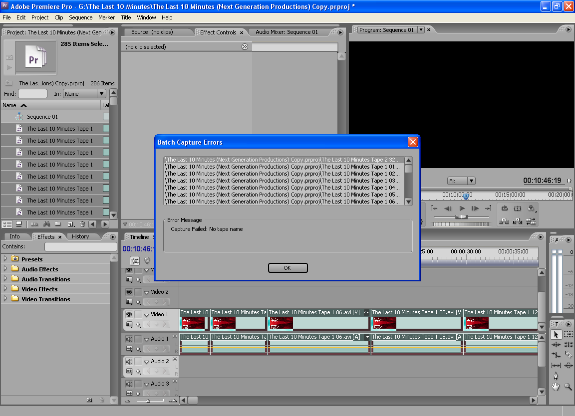

  2. well i do have the project file, but not the clips, thus i need to do a batch capture which is thankful because i have the tape, but as i stated in an earlier post, this is a problem:
    all i need to do is re-capture the tape (which i used Scene Detect to seperate each shot needed) as exactly what ive done in college, and yet it shouldnt be a problem if one does go wrong, as it relies on the time code exactly.
    so when i open my project, i get all my files on the timeline as i made it out to be, and of course they dont work because there is no actual video captured, so i highlighted the files in my project window and ordered to do a Batch Capture, but when i do this, it says that there is no tape given

  6. I am aware that u mentioned that u cannot help me any further, but i thought i would attach this, which could help shed some light on what im talking about.
    This is my problem.

  10. i see, and may i ask, how would u give a tape a name, cause im sure i might have, but it seems i didnt, shed some light to make sure i was correct or wrong?

  12. oh right that bit, i was very sure that i did name the tape, but then i could be confused for the Clip Name. Is there a way to bypass this or to make the shots from one tape be identified to be captured?
    and my source is from tapes, and not the hard drive.

  14. I've worked it out! i am not using CS3 on my PC and with the offline or unlinked files in the Project window, all i have to do is scroll right until i reach the title 'Tape Name' and i am able to click on each file under that title and label it! Once i have done so with one file, i highlighted it and went to File > Batch Capture, and wonderfuly, it went straight to wanting to capture the clip!
