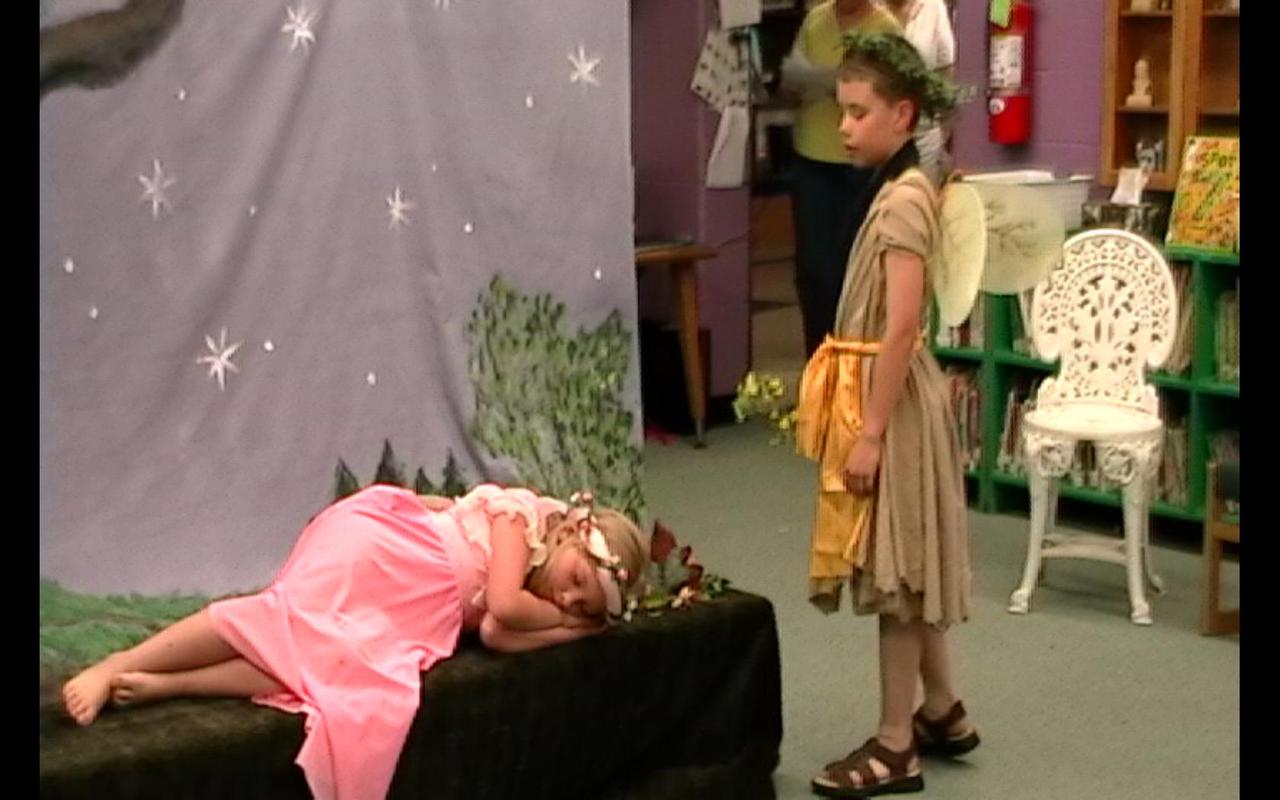

    Here's a screen shot. The lines are more apparent on my widescreen LCD monitor. Not so apparent on my 15" CRT. But still there. The photo doesn't look as bad as the movement in the video.
    Thanks.
  5. Your image is 1280 x 960 and so it has been enlarged (presumably from playing full screen). The artifacts may or may not be due to that.
    You need to capture a frame at its native resolution (720 x 480) and post that so we can see if the same artifacts are present. You should do that from VDub and from Windows Media Player to compare (they should use different decoders).

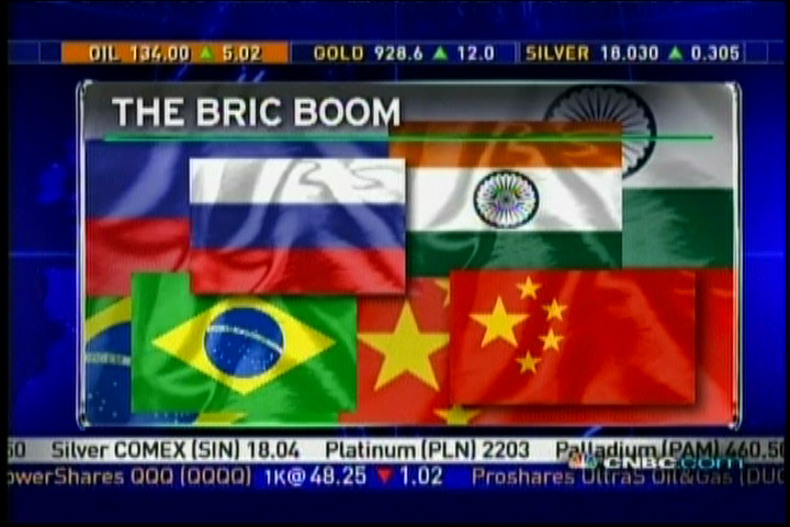

    VLC is also good at snapshot directly from the DV-AVI file. It would be a good crosscheck on any artifacts added by Vdub DV codecs. Snapshot is under the "Video" tab.
    Also VLC is good for deinterlacing DV playback. You will also find "Deinterlace" under the "Video" tab. "Disable" shows pure 480i (interlace). Try "mean" for 720x480p deinterlaced display. Below you see the results on the horizontal stock ticker.
    480i direct DV-AVI
    VLC "mean" deinterlace from DV-AVI playback.

  11. Originally Posted by edDV
    480i direct DV-AVI
    Hmmm. Notice how the deinterlacing has introduced vertical banding - e.g., the edges of the yellow diamond in the Brazilian flag.

    doesn't look like banding to me. more like typical square pixel diagonal line jaggies. it's compounded with deinterlacing as you've only got every other line, leaving out the smoothing of the in between lines. you can see it in the yellow stars also.
  13. I don't agree
    Look at these two samples. After deinterlacing, there are notable vertical bands (e.g., the upper horizontal edges of the star) that are more than two lines tall even in a region of the image where there are no interlacing artifacts.
  14. aBigMeanie aedipuss's Avatar
    Oct 2005
    666th portal
    your eyes must be better than mine, all i see are jaggies above and below the diagonal lines and no banding in the center of the star where there are no lines. the jaggies may join together where they are close, and look like banding. but i think it's just where the red pixels intruded into the yellow pixels at the corners of the squares. and the same with the yellow into the red areas. but what do i know

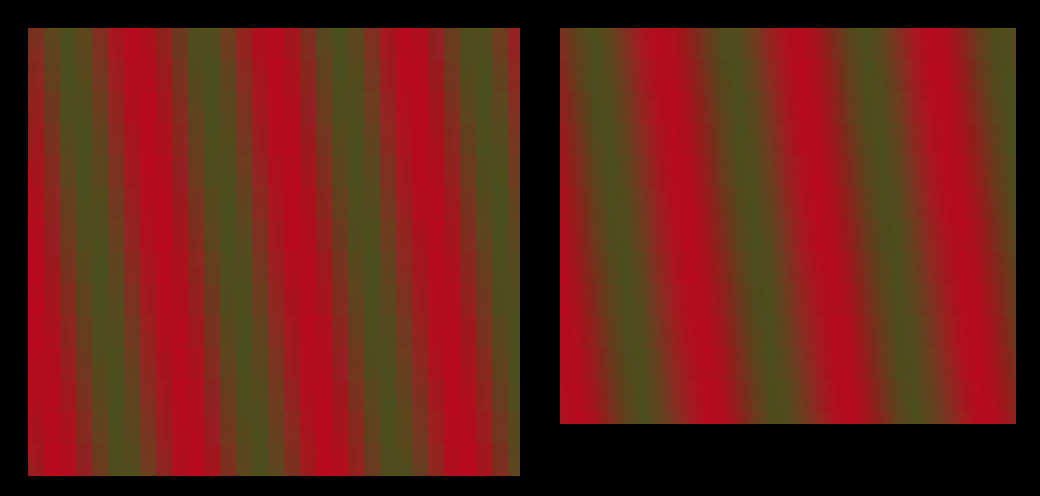

  15. I guess using MS Paint in a hurry didn't help.
    Here's a different take:
    As it happens, a couple of days ago I did notice this when play a DV file in WMP. I can't recall the details though (which PC, OS version, display etc etc).

    That's the mark of a DV decoder which is duplicating the U and V samples when expanding from 4:1:1 to 4:4:4. A filter like 4:1:1 Helper can fix that. Or using a DV decoder that does a smooth interpolation.
    Here a 4x enlargement (nearest neighbor) of a crop from a DV AVI before and after 4:1:1 Helper (in VirtualDub):
  17. But in edDV's example, aren't both images decoded with the same DV decoder but in one case displayed as-is and in the other the already decoded image is deinterlaced by VLC?
    If it were just 4:1:1 sampling, I'd expect to see it both images and the bands should be 4 pixels wide, not 2.

    It was intended as a quick illustration of playback deinterlace. VLC playback deinterlace methods are described here
    http://wiki.videolan.org/Deinterlacing
    The source was 524x480i 4:2:0 MPeg2 cable (comcast cable box) captured S-Video to a Canopus ADVC-100 (analog to DV conversion) then played with VLC from the DV-AVI file.
    A better test of the VLC deinterlace would be from a camcorder capture.

    Yes, you are right. After a closer examination, the light and dark streaks are 2 pixels wide and the pattern repeats every 4 pixels. If you take the original picture and split it into two fields (unfold fields side-by-side in VirtualDub, or SeparateFields() in AviSynth) you'll see that the separated fields have the light/dark streaks -- the weaving of the two fields in the original PNG masks this effect. I suspect they are related to NTSC dot crawl.
    I think vhelp is right, the images we see are a single frame far removed from the real source. It's hard to say anything definitive about the causes of the artifacts. Hey, edDV, if you still have the DV AVI could you upload a second or so of it?
    By the way, the left part of the image I posted earlier was decoded from DV to RGB by ffdshow (grabbed with VirtualDub's Video -> Copy source frame to clipboard). Using Cedocida instead gave a smooth result like the right part of the image.
