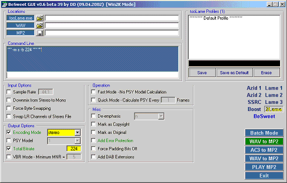

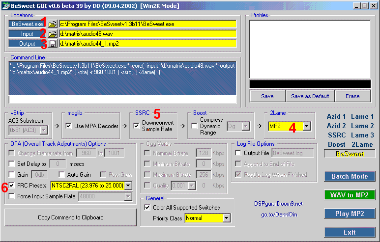

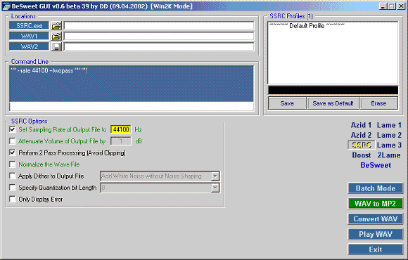

    2a.Audio with BeSweet
    Start the BeSweet GUI. Set the path to BeSweet.exe[1], input[2]and output[3] file.
    Select the output format[4], check downsampling if necessary[5].
    At the OTA section change framerate[6] from 960 to 1001 (23.976 to 25 fps). BeSweet does not support 1001 to 960
    (25 to 23.976 fps) yet. You may use Cool Edit.
    Go to the SSRC tab. Select options.
    At the 2Lame select the output options.
    Back to the BeSweet tab press WAV to MP2.

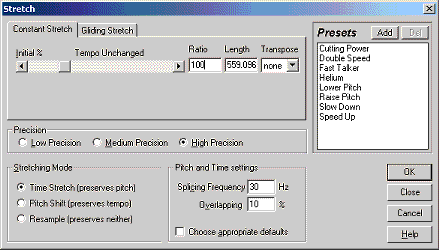

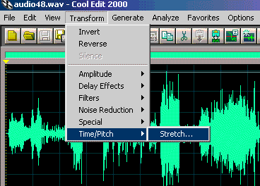

    2b.Audio with CoolEdit

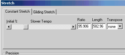

    Open the WAV audio in CoolEdit, select transform > time / pitch > stretch
    You see the origininal length of the in seconds, here 559.096 = 9:19.096 x 25fps= 13977 frames
    13977 frames / 23.976 fps = 582.96 = 9:42.96. Compare the time to the time of video file.

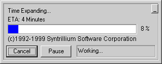

    Press OK. It takes a couple of monutes.
    Save as WindowsPCM (*.wav). Continue with downsampling (CoolEdit or BeSweet[ssrc]) and audio

    I tried using the built-in PAL->NTSC converters of BeSweet, it seemed to work, but the output had snapping every half second or so.
    Any suggestions?
