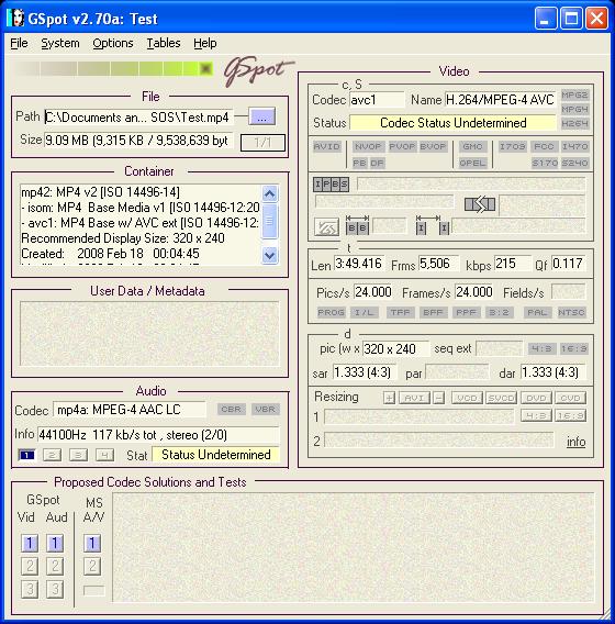

    Note the Gspot above. It played the audio OK, FF & FRev didn't work though. Possibly because it also said Unsupported Video Codec. However it did open the file with the MP4 extension.
