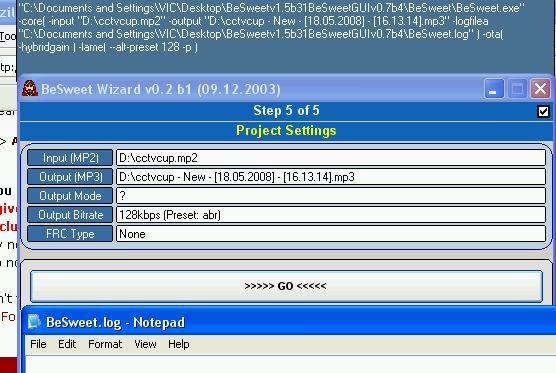

It is a good thing a lot of choices were given. Of all the free software (Winamp Pro is not free), I could only get Audacity to work (convert the mp2 to mp3). I am curious why Be Sweet did not work. I downloaded the BeSweetGUI rar and extracted to a folder and then started BeSweetGUI.exe wizard and inputed the mp2 file, selected mp3 on the output type, selected 128 on the bit rate, then hit "GO", but all that happened was an empty Be Sweet Notepad popped up. (See screenshot). I am curious why Be Sweet doesn't work.

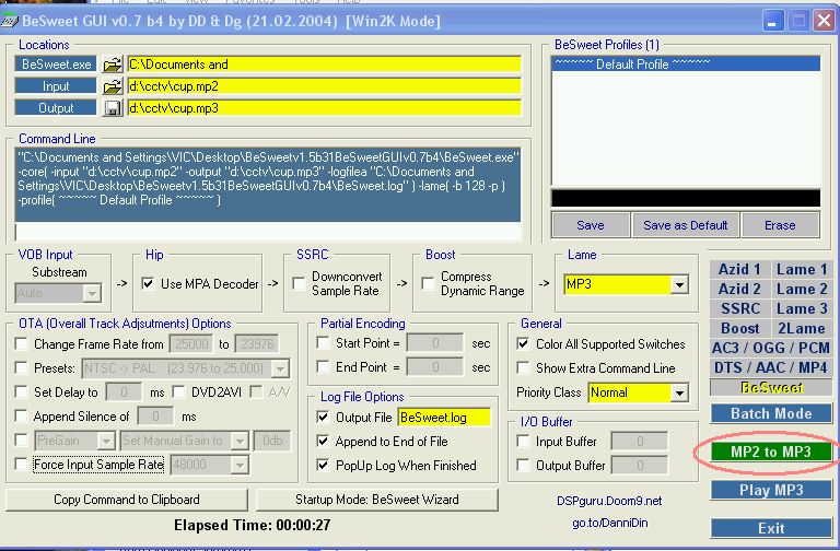

After several hours of trying, I managed to get it to work. The Wizard does not work. You must choose the "Be Sweet GUI" after you click the BeSweetGUI.exe. To convert from mp2 to mp3, click the "Mp2 to Mp3" button. (See red circle on screenshot). I looked several hours for "Start "button or something similar and so was barking up the wrong tree.

If I go back to the Wizard (BeSweetv1.5b31BeSweetGUIv0.7b4), even after I have confirmed that the software works perfectly using the GUI, and I haven't changed any settings, the software doesn't work. I press "GO" and the Notepad pops up and nothing happens. (See screenshot) I tried downloading another version of Be Sweet (BeSweetGUIv0.7b4) and have the same problem. I suspect this software is developed by a large company that sells software, and if some unsuspecting person uses Be Sweet, and has the same experience I have had, they will never use free software again. It is a method to make people use only software that costs money. One odd thing I noted is I can't seem to change the output (circled in red) file name. All that garbage (-New-[19.05.2008]-[11.09.29]) in the output file name seems to be created by some entity and I can't get rid of it. Also I notice that Step 3/5 is missing from the Wizard. Maybe the software developer doesn't like the number 3.

From the command line I see in your screenshot, you haven't got BeSweet in the folder the Wizard expects.BeSweet Wizard v0.2 b1 (09.12.2003)
Requirements:
***** All BeSweet Files Must Be in a "\BeSweet" Sub Directory of the Wizard *****
***** All Azidts Files Must Be in a "\Azidts" Sub Directory of the Wizard *****

Your command line shows Besweet.exe is in a folder calledOriginally Posted by jimdagys
c:\Documents and Settings..... etc
That's a strange place to put a program.
I suspect when you expanded the zip file you lost the folder structure.
So try this: create the folder c:\Program Files\BeSweetGUI

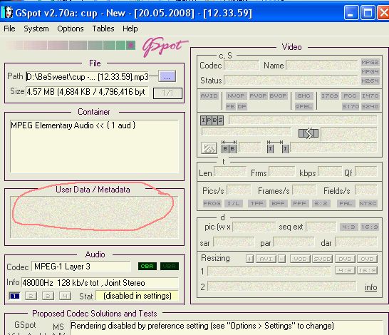

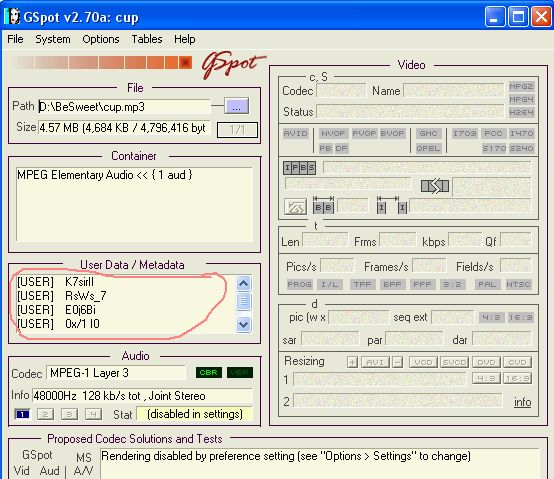

However, I do have another question. When I use the BeSweet GUI to convert a 5 minute file, it takes 45 seconds to convert the file. See screenshot 1 for the Gspot of that file. However, when I use the Wizard, it takes 1 minute 10 seconds to convert the same file. (See screenshot 2.) Both converted files have the same bit rate. Also see red circle that shows difference between the 2 files. I would like to know why when using the Wizard, it takes significantly longer to convert the file. Is there something I can change so that the Wizard will take the same time to convert as using the BeSweet GUI?

There are many different options when making an MP3 file. Even with the same bitrate, you can opt for higher quality at the expense of deeper analysis (more time). That's probably what is happening.Originally Posted by jimdagys
Both Wizard and GUI will display the command line they are using. And by default this will be written into the log file (shown in the Notepad text window which pops up on completion).
Look at these and see if they are different.
Paste the command line text here if you can't work it out. -

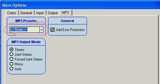

On the Wizard, I originally had cbr as "Mp3 Presets". I changed that to "None" (see screenshot) and it halved the encoding time (from 1 min 10 sec to 35 sec) with the same bit rate. Not sure what that does but it made a big difference.
If you look at the command line displayed, this changes with every choice you make in the GUI.Originally Posted by jimdagys
The "MP3 presets" are lame options, which makes sense as that's the MP3 encoder.
If you look in the Besweet/help folder, you should have a file "lame.htm" which explains what these do.
Anyway, as I said, some require more analysis so so take longer. Eg, normalising.
If you can't hear any difference, and the file works, don't worry about them.
