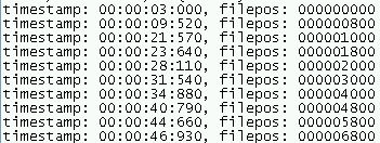

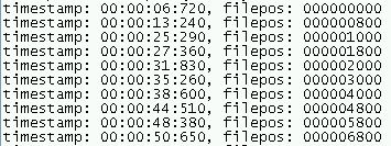

I tried to use SubResync (VobSub) and I was successful to adjust the timing of one subtitle. This appeared to then move all the subtitles by the same amount (see screenshot 1 and 2). The first subtitle was at 6.720 seconds and I changed this one subtitle to 3 seconds. However, suppose I want to compress or expand the timing (as in ntsc/pal subtitle timing errors)? In some cases, the first subtitle will be right on the time, but the subtitles will progressively get more out of time as the movie is played due to ntsc/pal difference. I need some software that will allow me to synchronize the first and last subtitles ( Time Adjuster allows this but it does not work with idx/sub files). I want to be able to adjust the subtitles and then quickly test the timing with Media Player Classic, before I spend the 6 hours converting the avi into DVD.

I found that I can sync all the sub/idx subtitles (compensate for pal/ntsc difference) with SubResync. The procedure is to first sync the first subtitle. (Step 1) If the first subtitle is presently at 5 seconds and you want it to be at 6 seconds, just type 6 seconds and save. This will also change all the subtitles by 1 second, but that doesn't matter. Then (step 2), go to the last subtitle. If it is presently at 60 minutes and you want it to be at 50 minutes, type in 50 minutes and also right click on the number and it will put a green dot on it and also right click on the first subtitle to put a green dot on it and then save. This will keep the first subtitle at 6 seconds and the last subtitle will be at 50 minutes. You can use Media Player Classic with the sub/idx files to test the subtitle timing.
