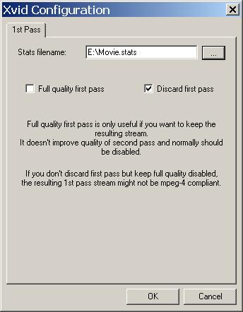

When configuring the first pass (2pass - 1st pass->More), you have to give a name and location where to save the .stats file. It's used in the 2nd pass. Without it there won't be a second pass.

It's created during the first pass in the place you designate, in my example above in the root of the E drive. You can even confirm its location in the 2nd pass config window (a different place this time):

A tough one, all right. I'd first try and "Load Defaults" in the main and first XviD Config screen to make it start fresh. Afterwards you'll have to put in all your settings again, including where the .stats file is to be saved. If that doesn't work, next I'd get rid of XviD in the Add/Remove Programs followed by a fresh install of XviD, hitting "Load Defaults", and then setting it up the way you want. And if that doesn't work, I'd uninstall XviD, uninstall Gordian Knot, and then reinstall everything again.
Or just cut to the chase and remove XviD and GKnot followed by a full reinstall. Lots of GKnot problems have, in the past, been solved by starting over again.
