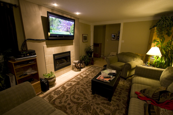

Below is a picture of our small living room:
We haven't had any problems - it's a gas fireplace with a blower. We used to have a mantle but the TV was too big. I'd have preferred to hide the wires but drywall is placed directly over the original brick - there's no room between to place the wires (we'll probably build a hollow mantle to hide them in).
Oh, and the lights above the TV can be turned off independantly from the rest of the lights in the room. -

Thats a sweet setup squirrel. Nice color scheme. Very warm and inviting. -
I read quite a bit on the subject and had a pretty good thread going over at another forum.
Heat was debatable - but with a real wood fireplace all strongly recommended not to place a TV above. The fear is the small bits of residue and not much you can do about it.
Thanks for the comment on the room - it's quite small but works nicely. -

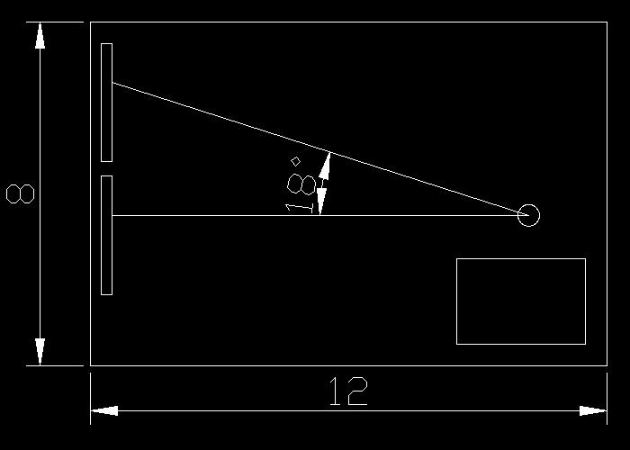

can't be good for your neck...
not to mention eye strain.
measure down 1/3 of the way from the top of the viewable portion of the screen.
this imaginary line should be right at where your eye level will be when you are seated to watch it.
every time I see a TV mounted 6+ feet up on a wall I have to wonder if the owner stands up to watch"To steal ideas from one person is plagiarism; to steal from many is research." - Steven Wright
"Megalomaniacal, and harder than the rest!" -
It's not great but it's not that bad either. Works out to less than 20 degrees total...
