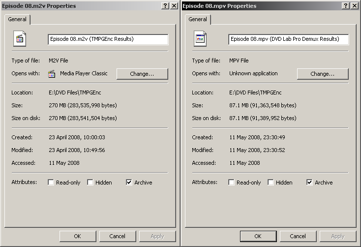

    Basically, I'm converting from .FLV to .MPEG (Version II) through the "Super" Conversion Utility (On Maximum Video Bitrate Settings, and 320 Bitrate Audio). Usually, I would then take those MPEG's and run it through TMPGEnc (Freeware Version) and get my Elementary Video & Audio Streams, slap them into DVD Lab Pro, and your away! But the Video File sizes from this process are about 200-250Mb, I took this result as standard.
    But I just tried taking those MPEG's produced from Super straight into DVD Lab Pro, and it Demuxed the Video/Audio File into Elementary Streams a Hundred Times faster then TMPGEnc ever does, AND with significantly smaller file sizes. The former just strips the Audio away leaving the Video, and the latter completely re-encodes it all to get the Elementary Streams, so the time required makes sense.
    So, the DVD Lab Pro Demuxing method gives me Video Files that are 50-100Mb in size, where-as the TMPGEnc method gives me 200-250Mb file sizes - yet BOTH seem to give identical Results in terms of Video Quality, despite giant File Size differences (Which ultimately determines the number of Video Clips I can fit onto my DVD; big opportunity here!).

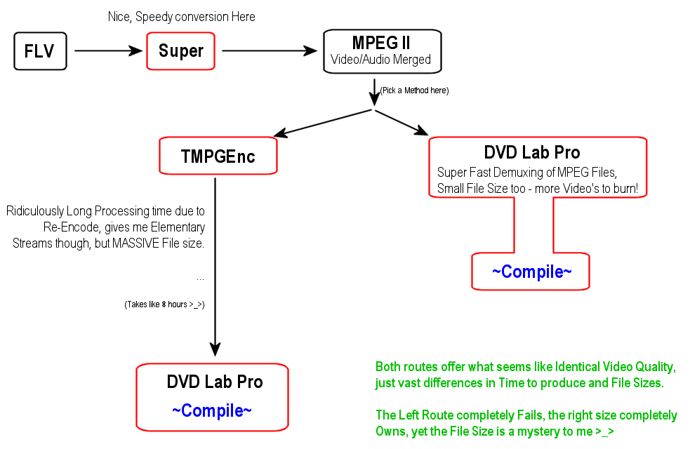

  2. Lol, I have way too much time on my hands, but this picture spells out the situation with some degree of accuracy Anything to make it easier you for you Guys (and Gals, if present!?)

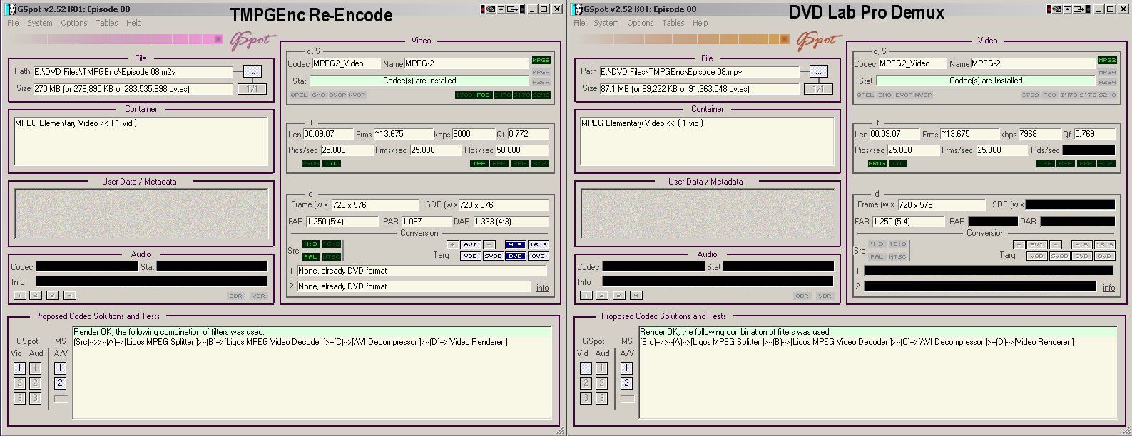

    So if the file is bigger the average bitrate is higher. Either you set it wrong or the program missed the mark. Posting GSpot results would be better.
  4. I made a big Boo-Boo, I lied, no, it's more like Plausible Deniability, and stuff :/ My bad. I don't have TMPGEnc, I have "TMPGEnc DVD Source Creator", which is very simple with no extra tools, 'tis dedicated towards taking a Source AVI file or whatever, and spitting out m2v and mp2 files -_- Regardless, from what you say, I interpret DVD Lab Pro is doing the similarly stated Job the normal TMPGEnc program can perform.
    As for the requested GSpot details, they seem fairly identical, but I don't have an understanding for the heavier details, heh.
    Thank you for the speedy reply too, Jagabo ^^
  5. Download the free TMPGEnc. It includes the MPEG tools.

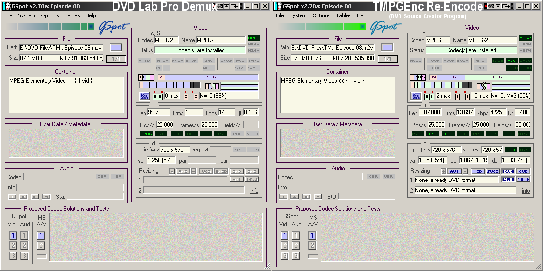

    Get a newer version of GSpot. And enable its "full scan" option. It will give you much more inforamtion about MPEG files. Options -> Settings -> Enable full file scan...
    I suspect the original file is VBR with a max bitrate of ~8000 but a lower average bitrate. Without the full scan option, Gpot reports the bitrate indicated in the header -- which is usually the max bitrate, not the average.

  7. Taking a low bitrate encoding and reencoding it with a higher bitrate will not make it look any better. Lossy MPG compression is like taking a shiny sheet of aluminum foil and squeezing down to a little ball. When you unfold (decompress) it the foil is full of wrinkles (compression artifacts). Squashing it down again to a slightly larger ball (MPG compression with a higher bitrate) won't make it look any better. It just gets more wrinkled.
    DVD Lab Pro compressed the video to an average bitrate of 1408 kbps. TMPGEnc recompressed it to an average bitrate of 4225 kbps. That is why the video has grown so much. Note that the ratio of 4225/1408 is almost the same as the ratio of the file sizes (270/87).
    1408 is a very low bitrate for a full D1 (720x576) video. Unless it's a 9 minute still video of a bowl of fruit it probably looks pretty bad.
