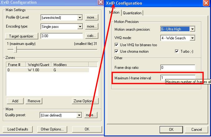

  3. The file that works is all I frames. The one that doesn't is both I and P frames. Set Xvid to produce all I frames and see if that works. To do this set the Maximum I-frame Interval to 1:
    May 2008
    Thank you both. Making that chang in VirtualDub corrected the differences (PVOP disappeared too), so the files look identical in GSpot, but my file is still unplayable on my player! However, I found that the manufacturer has indeed a conversion program. It doesn't do as good a job as VirtualDub (image quality is noticably poorer) but it's okay.
