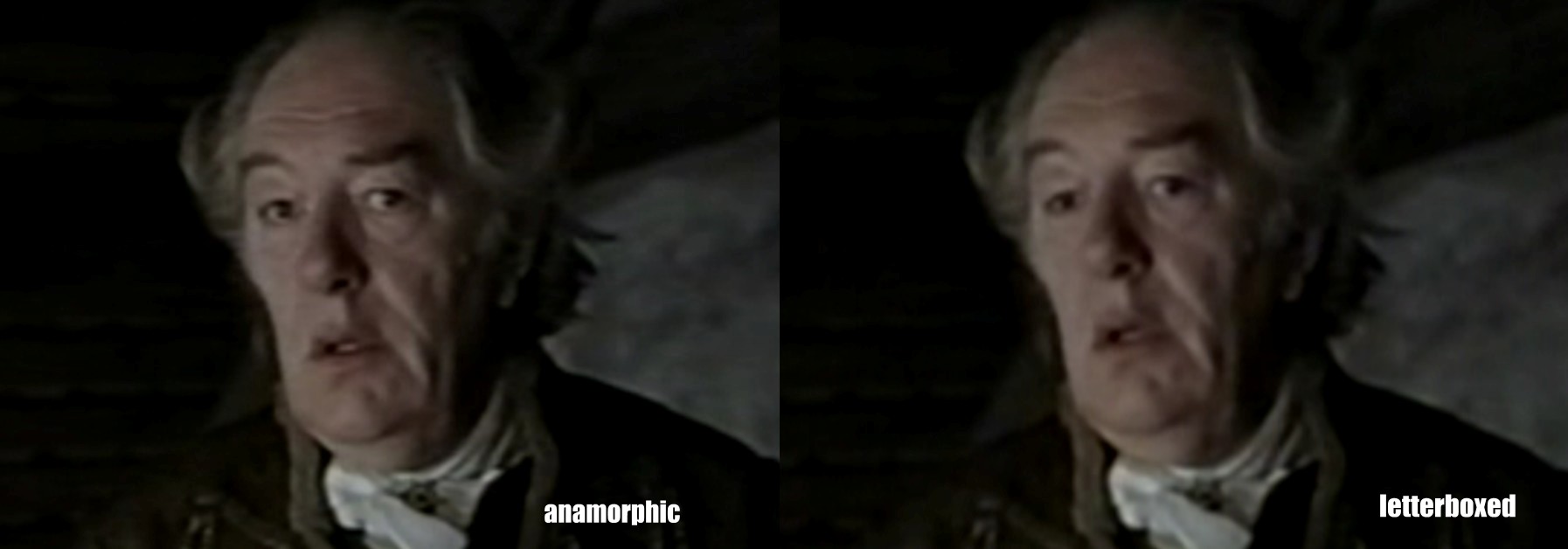

    I own many of the FS200 and i asked myself often the same question. I am always amazed how great the quality of this VCR is...could there be any better? Maybe these broadcast-S-VHS-Decks? Those grey, big ones?
    I tried also to demonstrate the maximum quality of this great deck by uploading a HD-Video on Youtube. Of course, with YouTube it loses quality, but still you can't see how good it is. NOTICE: This is NOT S-VHS, but just an ordinary VHS-Tape !
    I also have pictures here:
    I recorded those tapes anamorphic, with full-frame 16:9, which of course also brings lots of quality gain.
