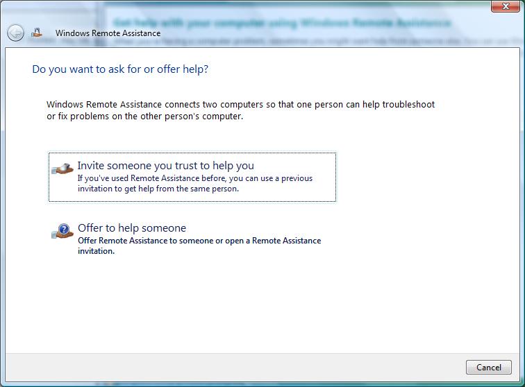

Windows remote needs to have a 'invitation' sent from the controlled computer and remote control needs to be set up also on the controller computer. It's also possible your invitation may have expired, as it's usually time limited. Firewalls commonly block it, so those also have to be set properly on both computers.

Maybe the invatation is only needed with Vista:
With firewalls and port forwarding, especially over the internet, I've never found any remote control program especially easy. But the help section in your Windows OS should give you all the info needed to set it up. -
I use RD connecting to Vista (as I type even) and there's no need to set up Remote Assistance.
