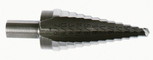

I drilled four holes in the plate that the motherboard secures to so that I don't have to keep removing the motherboard.
The holes are big enough to get a nut driver through to get at the nuts. Make sure you get all the metal shavings out of the case.
Here's the type of bit you need...
Those type bits are great.
I use them to enlarge the round holes in the case fan screens and they stay centered and make smooth round holes, besides being able to easily regulate the hole size. Improves air flow considerably with some cases.

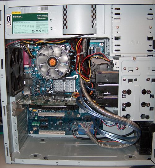

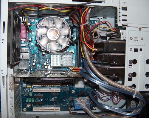

Here's a couple of picks
That looks like a good job of cable control.

BTW, I don't have a choice will cable management with this case...just not enough room. This is a pretty tight case. if you look at the video card (FX 5450) it's actually going under the bottom HDD and has a six prong power plug at the end too.
I also couldn't turn the heat pipes so the loops were facing up, because they would hit the PSU
If this case (Antec NSK4480) were 2 inches taller and 2 inches deeper, it would be perfect. -
