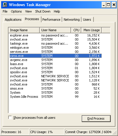

    Here are the current processes running on it, i cant even get an anti virus installed because it wont give me long enough to get to run the setup of it lol.

    from looking at your running processes i would start with your avg anti virus. there are parts of it missing from the running list. uninstall it and re-install, then run a complete scan just to make sure nothing a miss.

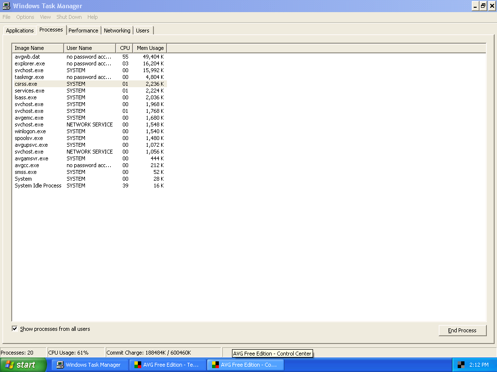

    oh and please put a check mark in the "show processes from all users" box and post the new list.

    Ok,
    Here's the latest, the only thing that keeps disappearing/reappearing from that list is 'explorer.exe'
    cheers fellas..
  11. aBigMeanie aedipuss's Avatar
    Oct 2005
    666th portal
    the avgwb.dat file showing up in the new list indicates avg is in the middle of a scan. it may have been scheduled and is running in the background. double click on the avg icon in the task bar and bring avg to the desktop and see what it's up to. if it's scanning just let it complete.
