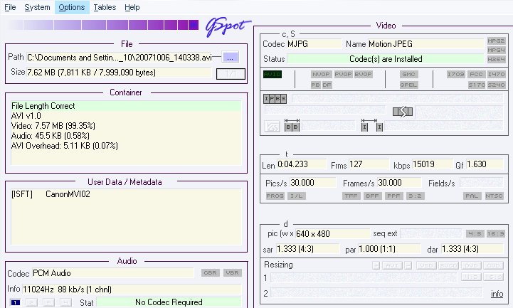

Start by posting a g-spot screenshot of the source avi files so we can see what you are dealing with.

I am attaching a screenshot of GSpot result. I have converted some files using Any-video-converter and file size is roughly half (Mpeg2, NTSC). But I am not getting volume in WMP, why should that happen?? Video quality seems good. I will try the other software and post the result if possible.
