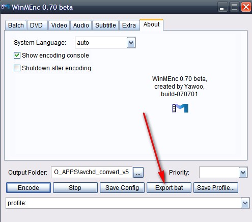

    With Winmenc, you can save the batch file once you've found the correct config:
    http://www.badongo.com/file/3605671
