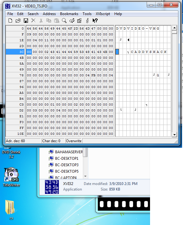

  6. So heres a screenshot using a hex editor that I can see TitleWriter put in the name of the disc, but yet again, my Sony wont read it. Where should this info be at?

    Okay - First the screenshot is of the initial vmg segment (VMGM_MAT) not the (VMG_TXTDT_MG)
    The Caddyshack area filled in is the Provider ID - Nothing to do with DVD_TEXT.
    PS -- Use ifoedit for dumps its Quite a bit easier (More verbose with labels)

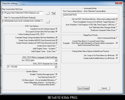

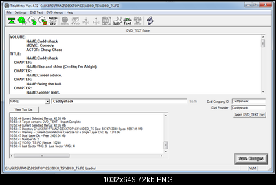

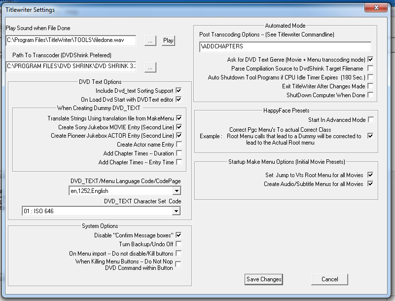

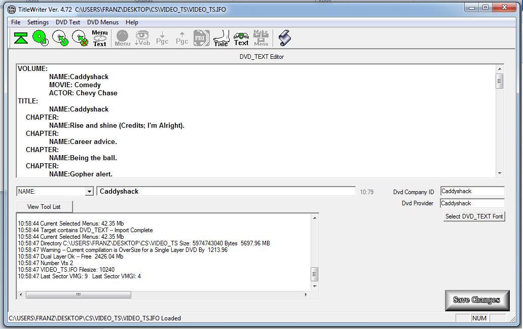

  8. OK, I tried this step by step and still "NO TEXT" on my Sony changer. Is my problem SlySoft??? Would that overwrite something? What other software should I be using? Again, total noob so Im trying to keep it easy, but the TEXT on my player is key. The kids are always taking the discs out and when their put back, they dont rename it. Pain in the ARSE. I see there are 300 diferent ways to to this, but im lookin gfor the quickest, easiest way. Any help all? FallenAngeL????
  9. Just so were clear, heres what I have.

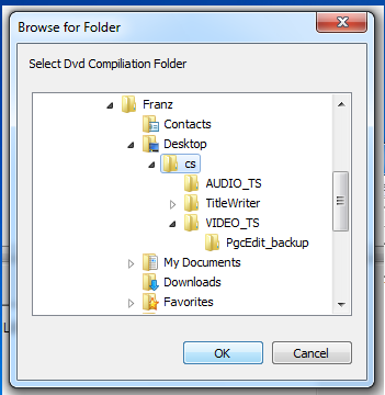

    Then when I burn the files, SlySoft will only pull it from the main folder. I cant point the Titlewriter folder as it errors out. Heres what I have:
    Any thoughts on this? Why wont my Sony DVPCX-985 see the text on this?? Wasting discs trying to get it to work right!!

    Okay -- Everything in TW looks right -- And if there was a problem with TW I would have heard about it long before this
    So Must be a local workflow problem
    First you don't burn the TW folder its the video_ts folder.
    and this phrase sounds very wrong
    "Then when I burn the files, SlySoft will only pull it from the main folder" -- WTF does Slysoft have to do with burning a compiliation from the HD --- especially with DL's (And I'm assuming you are using Verbatim)
