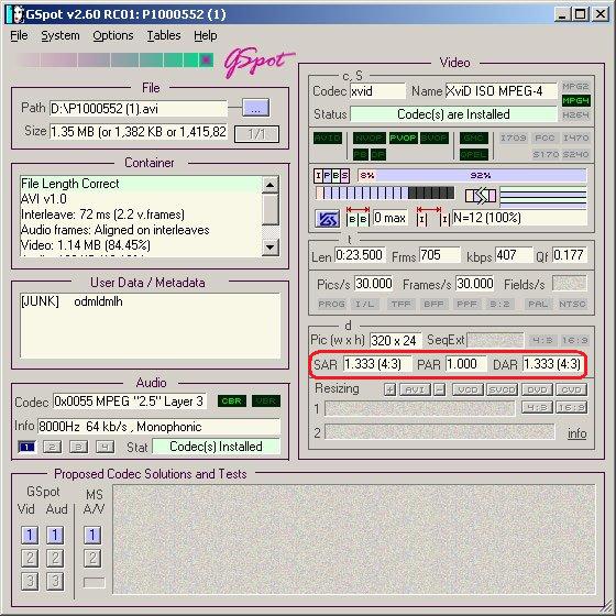

  3. How do I determine the aspect ratio? Meaning, if it's not widescreen should it be? Does this make sense?
    Ashley
  4. Mod Neophyte redwudz's Avatar
    USA
    You can drop the original video into Gspot and it will tell you the aspect ratio, 4:3 for this video:
  5. Note that GSpot won't report the right DAR for all sources. The AVI header doesn't really include display aspect ratio flags. Some codecs have private DAR flags that GSpot can read (DV AVI for example). But for some files (huffyuv AVI for example) you may need to eyeball the DAR.
