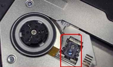

    Well, seeing as you already dug up kind of an old thread.....
    If the laser is going bad and you have to turn up the power to it, which is what you did, it will hasten it's death.
    How long will it last, who knows except you when it dies.
    The more you turn up the power to it, the faster it will burn out.
    And I am not sure what Bjs was going on about,
    Where do people get these strange ideas ?
    There is only 1 lense
    I don't see where any one said otherwise before he said argued the "fact".
    Although that is true the majority of the time, and might be always true now, I have in fact seen an old dvd player that DID have TWO lenses.
    I may still have it around in a junk pile, I will have to check.
    I will not have time to dig through my electronics junk pile until tomorrow, but here is a photo I found online showing TWO laser lenses on one drive mechanism.
    The one I saw was actually the only one I have ever seen, and I think it was an old goldstar dvd player, it has been a few years and it was pretty old then.
