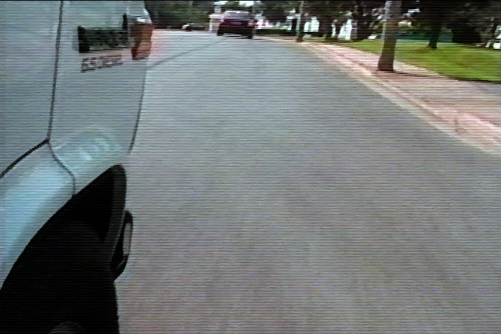

Just thought id post a pic of the issue im having. I do not know if a TBC will correct the problem, but hope something will since a lot of tapes suffer from it, either that or the player is adding it. However, most of them are atleast 10 years old and were not stored properly so anything to solve the issue would be great, preserving as much of the original quality as possible. As i said before, i have tried correcting this with de-interlaced filters a few times but it blurs the heck out of it.
Also, is there a name for this kind of condition?
The capture process is usually UmaticSP player - ADVC-300 - mac pro. Sometimes i have used the umatic player into a dvd recorder with the same result.
Any/all help is appreciated.

Actually i have a pair of Sony BUV-870 UmaticSP Editors. I also have access to a Sony VP-9000 Player. None of these are connected to a TBC, and are either connected directly to an ADVC-300 or a dvd recorder.

The ADVC-300 has a line TBC built-in, and some DVD recorders do too.
I wouldn't expect a TBC to help with this.
It almost looks like some kind of electrical interference that is causing the luma level to bounce up and down every couple of lines.
If you can't fix it at source, it might be possible to use one of the frequency domain filters in AVIsynth to remove the problem. Try asking on the doom9 forum, AVIsynth section.

I've seen this before (though it's been a long time), and I'm pretty sure (not 100% positive) I know what it is. The old tape is likely going bad. The compensation circuitry in the U-matic player is basically showing one field (every other resolution line) of the video frame, because it is having trouble making a stable picture out of both fields. You definitely need a TBC, but even that may not resolve the issue completely. De-interlacing will do you no good, since it is not giving you both fields.

That are white lines, mostly starting on the left and fading out at arbitrary horizontal positions. -
Your description sounds like "over-deviation" or "bearding." It is likely related to the quality of the tape. (Perhaps a bad batch.) I'm not aware of any way to eliminate this, unless you want to tackle it frame-by-frame.Originally Posted by mark23

I though that at first, and tried dumping every other line from his jpg. Result: it's not that! The visible lines probably have nothing to do with interlacing or dropped fields because they're not paired. The artefact stretches over 2.5-3 lines - whereas if it was interlaced or field related, it should act on line pairs exactly.Originally Posted by filmboss80
Still, if there's some additional processing involved which has hidden or changed this (scaling? capturing card gain bouncing?) then you could be 100% correct!

Thanks for all your help guys. I seem to have remedied the problem with virtualdub (what can that program not do). I used the 2d cleaner at varying levels, that and the temporal cleaner made a very acceptable fix.

How are you monitoring this? I suspect the U-Matic Player. Do any of your tapes play correctly?Originally Posted by mark23
Take one tape to a dub house with a well maintained U-Matic deck and have them dub to DV tape. Use this as a comparison.
PS: A high action scene would be more helpful for a sample. How did you frame cap this? It looks like a single
field. The small streaks on right edge of vertical lines indicate moderate head wear or over enhancement.Recommends: Kiva.org - Loans that change lives.
