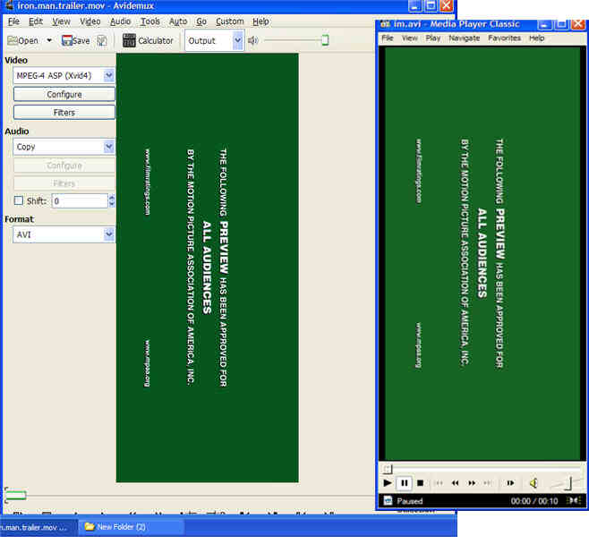

    If you toggle the view in the drop down menu at the top to "output" or "side" instead of "input" do you see the rotated preview?
    What did you set for the video, audio and format container?
    Ah, this is the stupid guy's problem. I did not set anything, so it's copy, copy, avi.

  7. For basic settings try MPEG-4 ASP (Xvid4) for the video sidebar, MP3 (Lame) for the audio, AVI for the format. Add your rotate filter. You can preview it before saving if you toggle "output" instead of "input." Press save with extension (e.g. "myfile.avi")
    You can adjust bitrate, quality, edit etc...If you provide more information on what you want to do with it, I'm sure people here can help.

    Leo48, go to Video > Filters, then click on the Colors button on the left side of the window. Add the Swap U and V filter, then click Close. Now the colors should be correct in the rotated video file.
    I've followed the same steps as you and also have errors in the rotated file. When I try to play the video in Windows Media Player, it just sits there doing nothing. I am able to play the rotated video in Media Player Classic though without any errors.

    You can not SAVE AS and retain the rotation without re-compression
